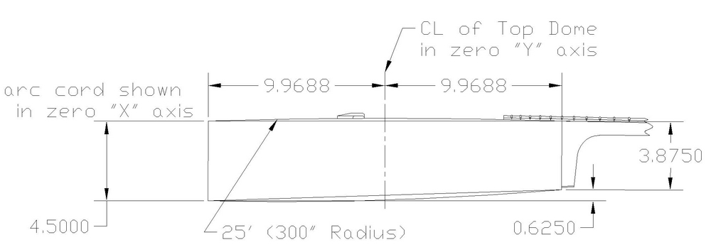

I am not sure who all I am in agreement with here, but I think Todd stated it best - the two drawings are in fact identical as far as the top, fingerboard plane, and bridge are concerned. All you have to do is rotate the bottom drawing up a bit so that the top to sides glue line is horizontal in both drawings - the tops are then identical in their layout. Assuming a straight line is drawn between the two blocks, the centre or highest point of the top is exactly halfway between, unless you sanded it weird !!! Changing scales or fret joint moves stuff a little but not enough to worry about, at least not when I build.
the discussion way back on the MIMF had lots of folks is a tizzy .. because mainly until someone establishes a frame of reference, someone can say almost anything, and in a certain context, its true. One guy said the peak of a domed top can be at the tail block .. well sure it can .. all you have to do is drop the headstock to the floor and then see, the tail is the highest point !!! But take the same guitar and point it to the sky and the neck block is the highest point .. am I not right ????

I must disagree somewhat Alan - if the top rim prior to putting the top on is level, then the peak of the dome is halfway between the outer edges of the blocks - agreed. Now if, as you state, you sand the tail block more than the neck block, you have a downward slope between the blocks - thats true, but simply bring the new plane you have established back to level, put on the top, and the peak is exactly the same as the other one, in the centre. What you have done though, is changed the angle of the sides to the level plane from 90 degrees to some other angle, which in this case is now greater than 90 - its all relative.
PostPosted: Wed Dec 20, 2006 10:00 am
Tony you are correct. I was setting here going something is wrong in my drawing then I realised the tops arc cord is not at zero in the X axis it was a copy rotate error. Simple geometry and I missed it.
Brain fart
If the guitar was rotated so that the top cord was true zero angle
Bad miss for an engineer
What is worse is I build this error into my sanding fixture for this guitar .088" dropMichaelP39071.7512731481
PostPosted: Wed Dec 20, 2006 10:16 am
Micheal I am laughing to myself as I post .. I was looking at your first drawing going, wait a second something is wrong here, thats not possible, and was trying to see how and why you got the two numbers you did between the blocks for the peak - then I saw it - the arc in dwg 1 is not truly level, it is stepped .. and then you reposted !!!

You have no Idea how dumb I felt yesterday. I am supposed to be a geometric whiz well this layout whizzed right by me for almost a year MichaelP39072.5107638889

Ah - But you havent put the guitar with the lowered tail block back down on the level bench (your initial reference plane) - you have changed it, so of course the peak is in a different spot. Think about where the fretboard planes of those guitars would be - are they the same plane - no they are not. The comparison is meaningless.
Using your reference - the level bench top between the blocks, every single guitar with a 28ft (or any other) radius, now matter how you sand the blocks, has a peak in the centre just like Michaels drawing. Its mathematically impossible to be anywhere else.

Michael, if you have the rim of the top level, (x=0)then a simple line drawn parallel to the rim and tangent to the arch of the top will give you the location of the apex.
To me, the whole question is moot because I don't make my top spherical. My rim is flat for the top.
