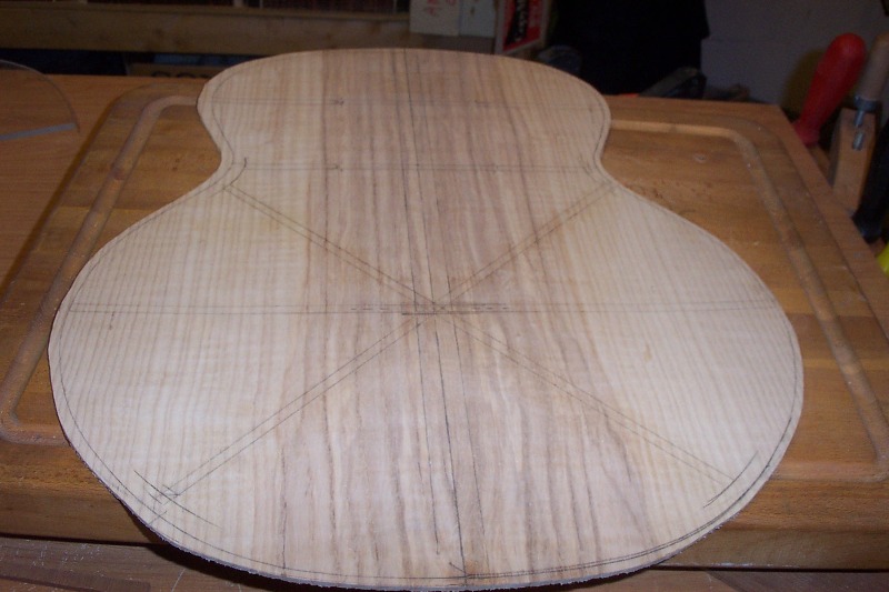

Here's the brace pattern transferred on the white ash back

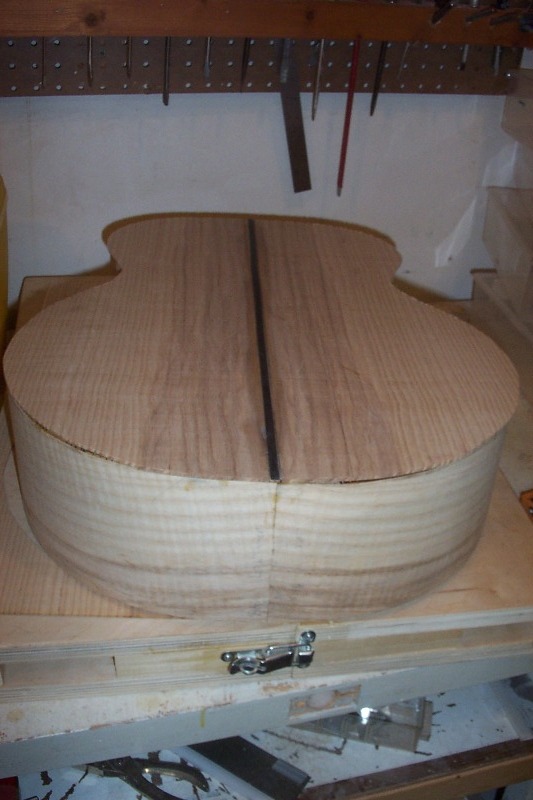

cut the contour of the back and it starts to look like this box is quietly taking shape!
Today, i also cut all the brace stock to length and heith but will inlay the ebony backstrip in the back prior to glueing the braces on the plates, i would have taken pics of where i'm at now but relatives stormed at our place today and stayed for dinner, will show more tomorrow!

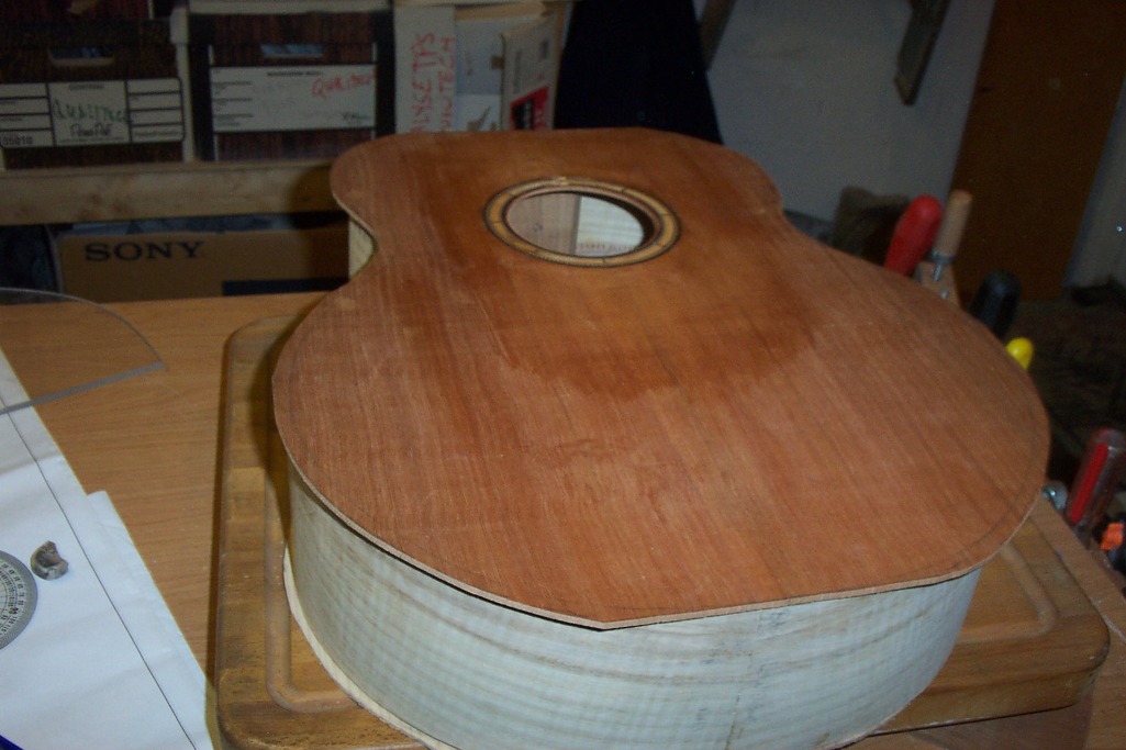

Well, here's another nod to a fine looking rosette.
Good composition, nice contrast to the top.
And, it will look appropriate for the light colored sides/back.
You're keeping your elements down to managable levels,
and they're all working nicely together.

    Serge Buddy! I like this a lot! Between Hesh's great combos and yours there's all kinds of possibilities opening up! What gave you the idea for this?

QUOTE:Serge Buddy! I like this a lot! Between Hesh's great combos and yours there's all kinds of possibilities opening up! What gave you the idea for this?
the materials that were available my dear friend! Seriously though, i took the idea of rope purfling from a fellow OLFer who's name i can't remember but who had used herringbone, rope was then obvious to me since i had a few strips left

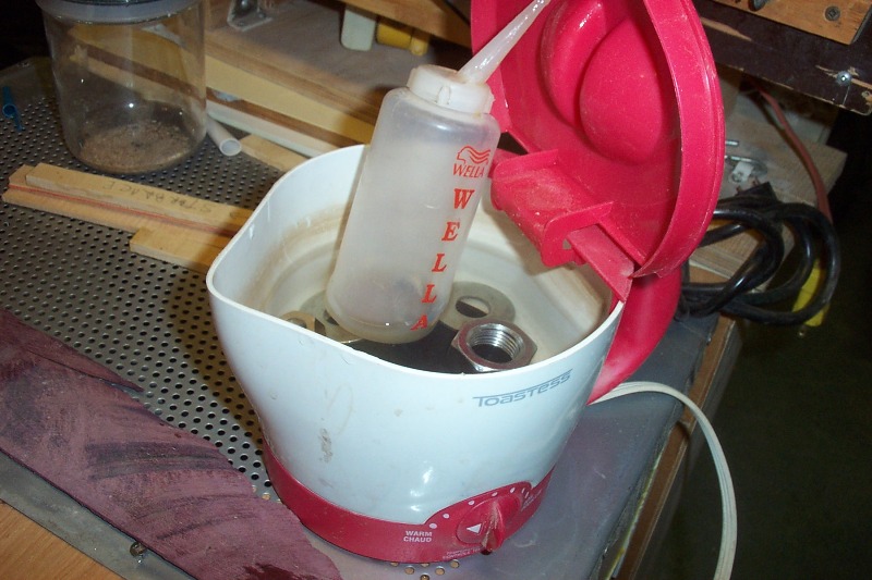

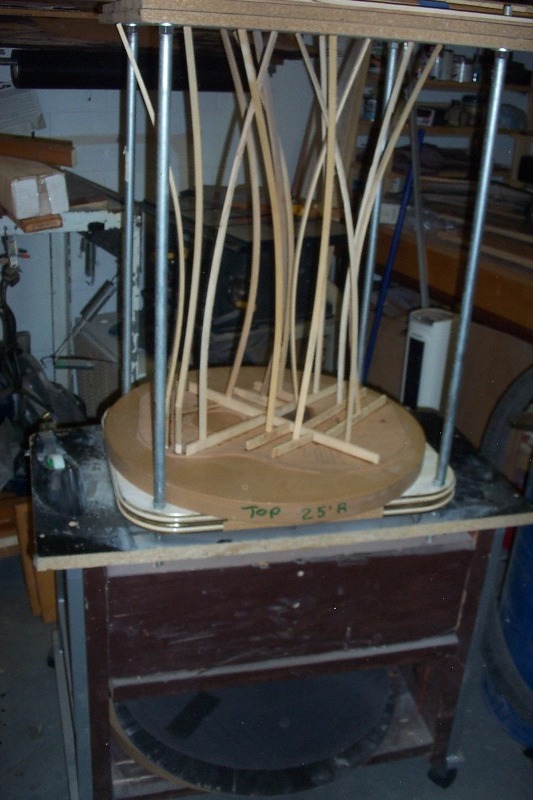

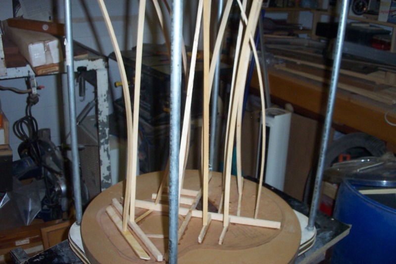

This is what i was up to tonoght...
Prepared some hide glue that i had in the freezer, did not have any beads anywhere in the shop so i used bolts and washers to cover the bottom of the hot pot
glued the braces on the underside of the top, this time, i was a bit more neat than on no 2, i used a sort of pointy scalpel to clean the excess after 5 minutes

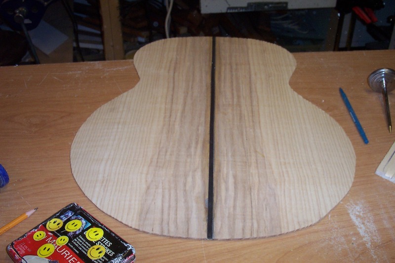

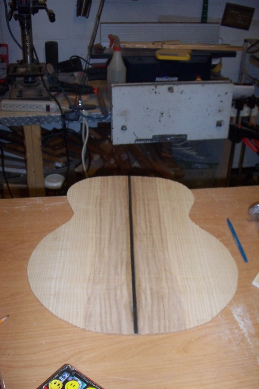

And finally inlayed the ebony back strip, first time i work with it and loved it! The only bummer i had today was a slip of the router and made a larger pass at the lower bout, filled it with white ash dust for now but i will probably have to sand and refill that area though!
Thanks again for watching!
