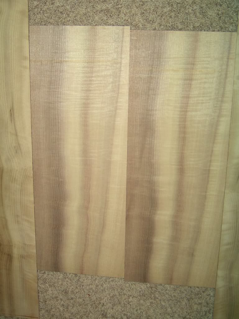

OK - These are the specs so far - Please let me know if you have any suggestions - like binding. I'm not thrilled with the maple choice. Carpathian spruce is real light and here is a picture of the myrtle.

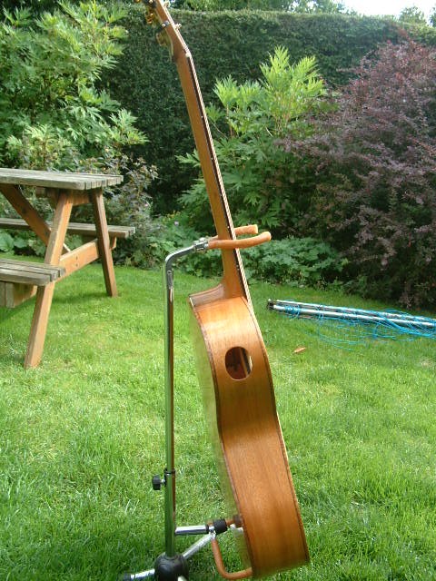

I'd seriously consider a soundport like this one:
I think they work really well with baritones.

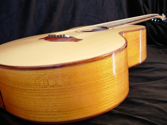

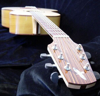

I built a baritone a few years ago on an SJ body, close to a J-185. I used a 28.75" scale (which I think was a 34" bass scale with the first few frets chopped off); neck-body join at the 15 fret, which bumped the bridge back a little bit but not all that much.
The calculations I did at the time suggested string tension reasonably close to standard tuning for a 25.4" scale, though that varied with the string gauge and tuning, of course. After it was built, I played with several string combinations to get the right feel.
I used roughly the same top thickness and bracing as usual, but I closed the X-brace somewhat to increase load bearing along the axis of string pull. I also built it as deep as I could stand (maybe 5.5" when done -- I'd have to check my notes) because a larger volume would better be able to make the low notes we're after.
I used a stiffer adirondack top and osage orange b/s and was pleased with the result. Still seems to be holding up just fine.
Myrtle is lovely stuff to work and should be fine.
I found a couple pics, which I'll include if I can. The appointments are all African kingwood; the uneven ebony pins were temporary as I had yet to turn a few from kingwood.

Thanks. That is beautiful.

Great looking guitar!

[QUOTE=Bob Steidl]
Bob,
That's a lovely looking instrument. Nice choice of woods that work well together and the Kingwood is lovely.
How did you think the extra depth worked out in terms of supporting the low notes?
What tuning have you settled on?Dave White38982.5828009259

Thanks guys, sorry for the marginal pics but they were a last-minute thing.
There are several papers that detail "scaling" of stringed instruments, mostly in the violin family, but a general rule is that you need a bigger box to produce lower frequencies which I think makes sense. So I don't have any rigorous basis for calling the instrument more or less successful than a more shallow one, but it seems to work fine.
The instrument was commissioned, so I only got to play it for a week or so. But the tuning you want to target will depend on the scale and string gauges you use.
