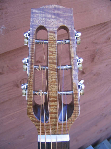

This is probably irrelevant to you, but I'll post a pic of one of my steel string heads. I like it pretty well, but I don't think I'll do another crest like that.

...This is probably irrelevant to you, but I'll post a pic of one of my steel string heads. ...
Not at all, when I'm working on the something, I always like to see examples of what others have done. Very nice, I like the shapes of those ramps, with those curves matching that well you must have invested some time with the needle files. BTW I like slotted heads on SS.
