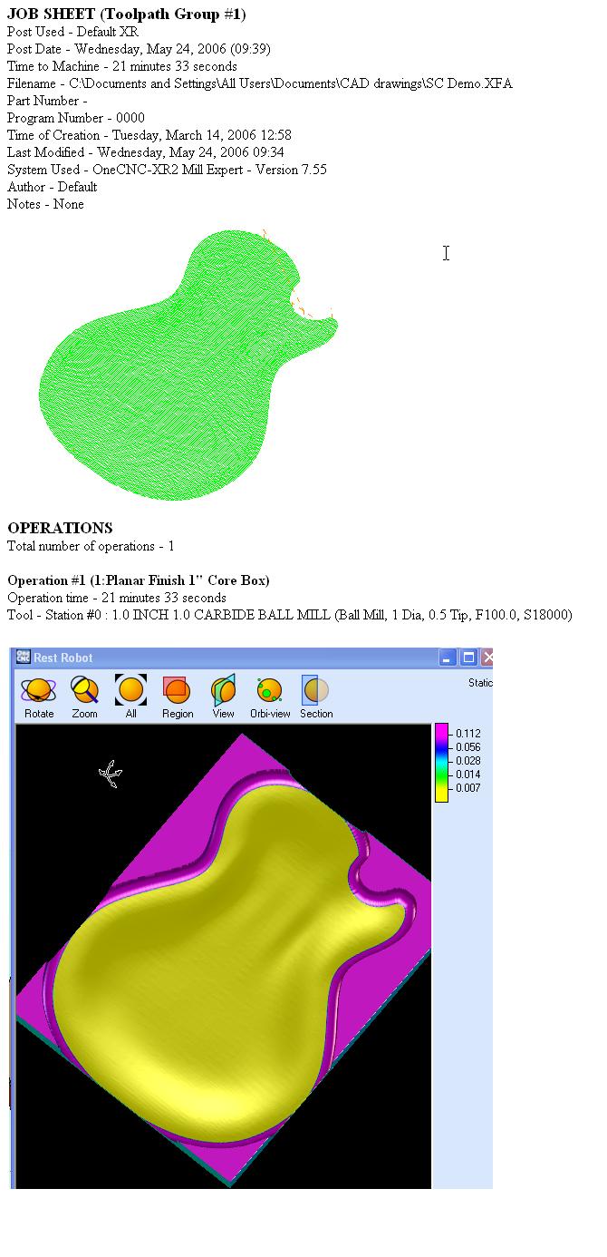

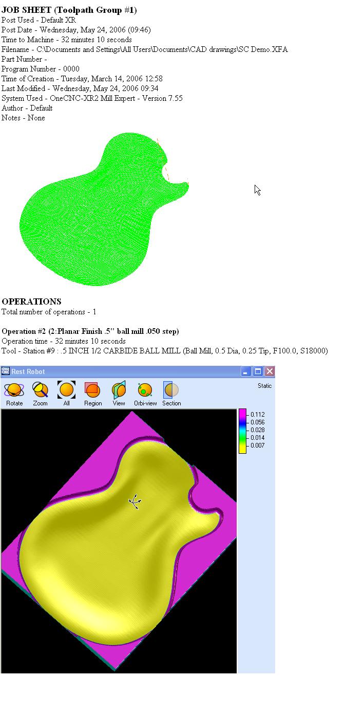

You can play the what-if's on bit sizes, stepovers, feeds & speeds etc with your software.
For example, a singlecut top with a 1" core box bit:
And with a .5" ball end carbide spiral for wood:
The core box bits are less expensive but shorter in length. The ball mill diameter is generally limited to the shank size and they are 2x the cost. I use them both where they work best.

Rand, I must be missing something, but I don't see how that tells you which cutter will work better. Can you elaborate?

Both cutters have the same profile, ball end, and in this case the part's features don't require the smaller diameter so the difference is amount of material to cut in a pass (runtime). In this case the what-if showed an 11 minute shorter program run by using the 1" core box bit for a similar finish quality. I'm sure these settings could be tweaked and the feed is rather low at 100 ipm for discussion purposes. A 2" core box is faster but the surface quality suffers a little. More meaningful when trying to figure out which tools are best for parts like necks where roughing and finishing are needed and trying to determine the best toolpath strategy to get all the part features. YMMV
