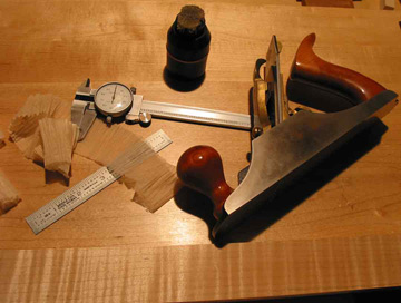

[QUOTE=ToddStock] .001 full length, full width shavings in curly maple. Chisels are pretty sharp as well. If you can't read through the shaving, your tools are not sharp enough to work with.
Yowser! Todd, this just about makes you the "GURU of SHARP!"
I'm impressed. I could only read thru my shavings if my name was Superman. Kudos to you.
PostPosted: Thu Apr 06, 2006 3:35 am
I'm gonna send you a plane to get working like this! It would be fun just to see this done. Most people mess around with a plane a while, get disqusted and never pick it up again. I'm almost that committed to them. But with results like you have above, you could start a luthier revolution to hand tools..... no joke.

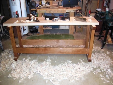

Check out my latest planing effort in this laminated hard maple bench core. I used 3 Anant planes (#4, #5, #7) upgraded with Hock irons and chip breakers. Each one produces full-width long and thin curls. I use the scary sharp method and strop frequently to keep the curls consistently thin and long. I learned sooo much during the many hours it took to level the bench over the weekend. This was by far the hardest wood I've ever attempted during my short, never-ending, self-imposed apprentiship. Without proper setup and quality blades I'm sure I would have failed miserably. Keep the faith, Bruce...anybody can do it if I can.
I'm sold on the polished and shimmery surface that quality planing produces...it far exceeds anything that I can get from sanding even with the finest grit papers.
