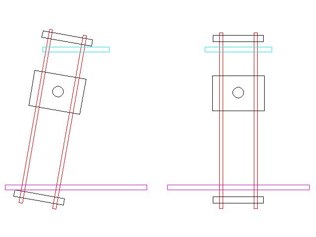

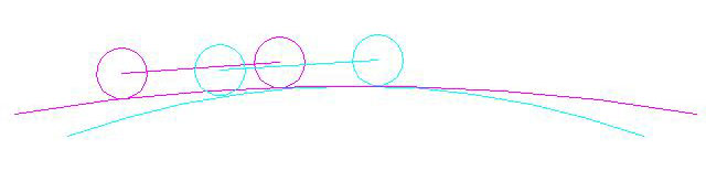

I'm going to have to disagree on the fixture concept in general. I'm assuming that the tubular frame is rigid and as such it will swing a constant radius. I believe that this constant radius is going to be equal to half the difference between the two radius templates.
In other words, if one template is 10" and the other 16", then the tubular frame will swing on a 13" radius. The router has to swing on this same radius as it is mounted to the frame.
I realize that the actual radius of the templates have to be adjusted depending on their location relative to the fretboard being radiused. (as mentioned in height adjustment statements above)
I believe that to make this fixture create a compound (conic) radius, the cutter would actually have to move up and down (as in plunge router) as the router is slid along the length of the tubular frame.

[QUOTE=npalen] I'm going to have to disagree on the fixture concept in general. I'm assuming that the tubular frame is rigid and as such it will swing a constant radius. I believe that this constant radius is going to be equal to half the difference between the two radius templates.
I don't know, Nelson. If you have two different radii with a rigid frame, consider the following. Look straight down the tubes, lining up the crowns of the two radii as shown below.
When in the center, the tubes won't have much of a problem. But look at what happens as you move the frame to the left. If you press both tubes onto the larger radius guide (magenta), then one tube will lift off the smaller guide (the cyan) as shown since the tubular frame is rigid you said. If instead you press both tubes onto the cyan side of the jig, then the opposite tube will come up on the magenta guide. With the frame (with the router bit somewhere in the middle!) teeter-tottering I don't know how you'd get an average 13" radius - you'd have a mess of a fingerboard as the end of one tube or the other alternately lifts off a radius guide.

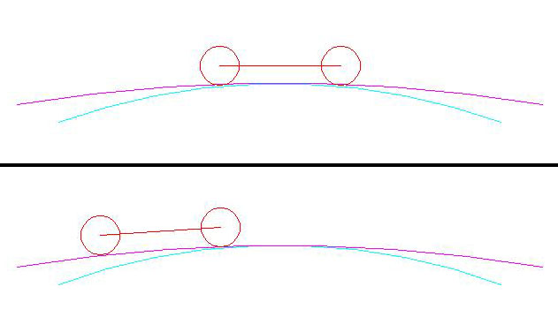

[QUOTE=npalen]
No, not really. The bit stays at the same protrusion from the router, but during set-up you adjust the height of each radius guide such that the bit just barely kisses the crown at each end of the fingerboard. That way, everything inbetween is OK too. But the difficulty in executing a compound radius on this kind of a jig is that you'd end up moving the sled more on the larger radius end than the smaller radius end as I said previously. This by the way keeps all four ends of the two tubes in contact with the radius cauls. Below is a picture. That picture also may help explain what I was saying in my previous post.
Moving the frame in such a matter keeps all four ends of the tubes on the radius guides (see below). I think you may need more than two hands to move the two ends of the frames as well as the router at the same time, though!
(By the way the ends of the tubes are now magenta and cyan to indicate which radius guide they're resting on).Pete Licis38811.6963773148

BTW, I can't see how a ridgid frame will cut a correct compound, either.

Pete--I totally agree with you. I got to thinking about the teetering issue also.   Looks like a 3-point contact would be needed with the frame guided by another slide of sorts that would keep it square with the world. I'm really not sure what that would produce however <g>
An interesting discussion, at any rate. That said, I do enjoy the "mechanical" part of any discussion much more than the political side.
Again, great illustrations! Picture is worth a thousand.....

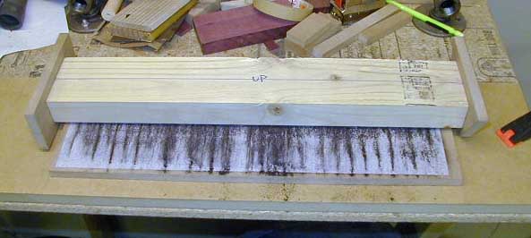

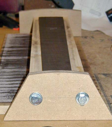

[QUOTE=npalen] Pete--I totally agree with you. I got to thinking about the teetering issue also.   Looks like a 3-point contact would be needed with the frame guided by another slide of sorts that would keep it square with the world. I'm really not sure what that would produce however <g>
Now for my non-theoretical in-practice view ... I don't know why anyone would build anything so complicated. Buy, yes - it saves a lot of time over building it. But, I just take a jointed 2x4 and a couple of radius guides as shown below, double stick tape the fingerboard to it:
turn it over and sand away, randomly tilting it on the radii until no more dust comes off the board.
Then you have a perfectly transitioning radius from one end to the other!
(By the way, note that the radius guides have a slot [barely visible] that the lag screw goes through so you can get the up/down adjustment I talked about earlier).Pete Licis38811.7349537037
