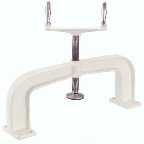

Here's a link to a clamping 'press'. I read that Harmony used something like this for tops/backs with HHG.
http://www.grizzly.com/products/H5510

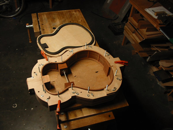

I clamp my tops and back like this .
The form has a 20ft radius in it which is in between my top and back radius, the black on the clamping form is a foam which comforms to the top/back under clamping pressure.
In use, I put all these studs into my mold apply the glue and top, drop the clamping form over the studs and put on a bunch of wingnuts.
Works pretting well. Oh I've also used an old bicycle inner tube infalted against the top, just one more option of the endless variety out there!
Good luck.

Thanks again Terry for this great tip of the alignment pins, that was exactly what i should have known for my first!
Jim, love your set up too, very brilliant, since your clamping form was made with a radius such as this 20', you never have to worry, it'll match both 15' and 25' with that foam padding! Very clever!

Looks like the caul that Jim Watts uses in the picture above would work with weights. Or a clampin press like this:

[QUOTE=crowduck] [/QUOTE]Looks like the caul that Jim Watts uses in the picture above would work with weights. Or a clampin press like this:
Yes, as long as the foam is stiff enough to make good contact along the edges, while holding the center of the caul off the top/back. The screw press would work, but you'll probably need more than one, or some additional clamps/weights at the ends to assure uniform pressure all around. Jim's wing nut system guarantees equal pressure. Go-bars would also work.

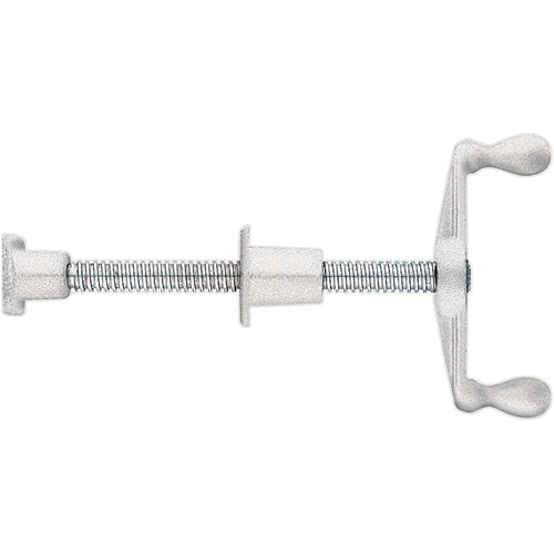

Or perhaps some of these veneer press clamps.
