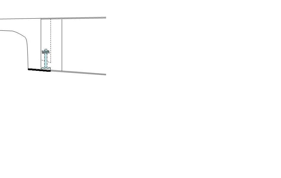

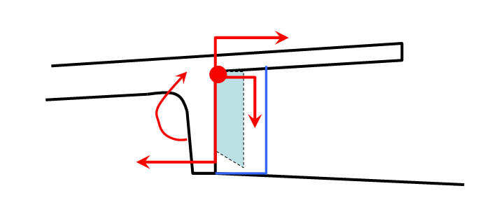

Todd, how about one inward and one downward like your sketch, wouldn't it secure the joint on both axis?
PostPosted: Wed Mar 29, 2006 10:42 pm
Ummm....I don't get it? Why would you need downward force? A tight dovetail can pretty much hold itself. You don't use downward force with a M&T, why would you need it with a dovetail? If anything, it's far less prone to slipping than a M&T, especially when it fits snuggly as it should. I'm having a hard time wrapping my brain around that...
PostPosted: Wed Mar 29, 2006 11:10 pm
I think he means that the bolt will pull the tenon tightly into the mortise and secure it by wedging it tight. This would require a V-shaped (and not straight) dovetail, as in a Martin one; a dovetail that is wider towards the fingerboard than towards the heel cap. Todd, am I close?

The traditional dovetail had two angled surfaces. These surfaces work together to secure the neck into the head block and pull the neck flush. As you push down on the neck, the tenon needs some place to go. There is more room at the back of the headblock because of the dovetail. The neck is compressed against the side of the guitar and sits nice and tight.
One way to visualize these sorts of things is to imagine how it would work if there was only one of the angles. Suppose that it was just a V shaped tenon. As you pushed the tenon down it would align the neck virtically and horizontally but there would be nothing to draw the neck into the body and you could pull the neck straight out.
No suppose that you have a simple dovetail that has parallel sides. This joint would keep you from pulling the neck out and provide alignment but would be as tight or as loose as you cut the slot. It would be very easy to go from too tight a joint to too loose a joint with just a few strokes of sandpaper.
With the compound joint, that last little bit of downward pressure that you get when you clam the neck to the body is also the part that pulls the neck tight against the body.
If you add a bolt to pull the neck the neck into the body, you are actually releasing the pressure on the mating surfaces of the dovetail. Consider an extreem case where the dovetail was set too loose. The bolt pulls the neck into the body and the sides of the dove tail pull apart and may not even touch each other. In that case you have, structurally, the same thing as a pure bolt on and even lose the alignment that a straight tenon would give you.

When Don first pondered this, I had been considering it as well. In fact, the sketch Todd shared is pretty much exactly like one of my concepts! An alternate to that would involve a foot on the neck block and a leverlike clamp that would fit into a notch in the male of the dovetail to apply downward pressure. In any case the downward pressure would be key to allow the dovetail to work it's natural holding power. The bolt just replaces the hold that the glue would otherwise provide, right?

From a structural standpoint, bolting a dovetail doesn't make sense, because you are, as a few have [pointed out, pulling it apart with the bolts. Yes, it works, but it works as a bolted neck, not as a dovetailed one. The only advantage to this style is that you can tell you customer that they are still getting a dovetailed neck. Since few understand the geometry involved in a dovetail, few will question whether it is a good thing or not.
The only way bolting a dovetail would make any sense, structurally, is to do it like Todd drew up, pulling it tighter. problem is, where do you access the bolt, such that you don't have it showing?

Great illustration,Todd.

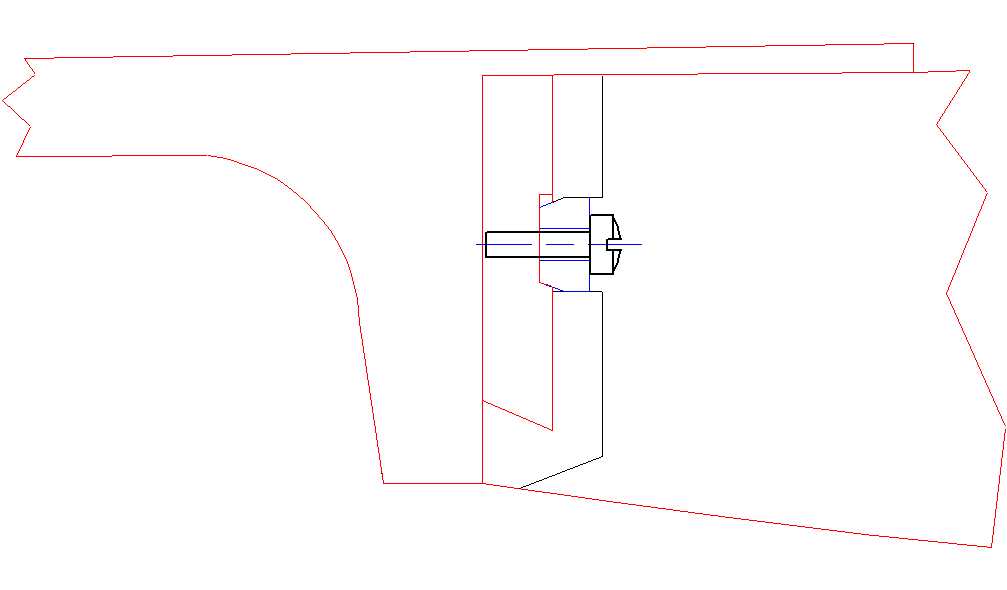

Okay, this had been my concept a while back in order to "conceal" the bolt as Mario mentioned earlier. Sort of a COMPLICATED version of an interference fit like in timber framing. The washer as it may seem in the drawing has flat sides so it's more like a wedge or cam. However, I have always felt that the method illustrate earlier by Todd with the bolt at the bottom the simplest. Just conceal with an extended variation of a heel cap.

You guys beat me to the punch -- I made up my diagram so I'll post anyway
I know I mentioned that I use a dovetail joint – having said that – what Mario says makes a lot of sense.   If you look at the diagram below, the natural string tension will try to rotate the neck around the point where the inside of the heel meets the underside of the fretboard extension. The string tension will try and pull the heel away out of the body, while at the same time the fretboard extension is pushed downward on the top.
I think I get what Mario is saying – you don’t need a neck tenon and it doesn’t make a whole lot of sense to try and bolt a dovetail joint either.
If you want to bolt your tenon to couteract the forces trying to pull the tenon out of the body -- no point in using a dovetail joint.Anthony Z38806.5590046296

The thick black line is the heelcap. Todd, please pardon the use of your drawing, but I believe this would best serve Don's objective. You got us all a flutter, Don! Good luck!
