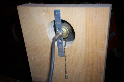

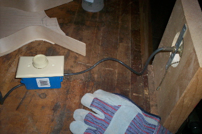

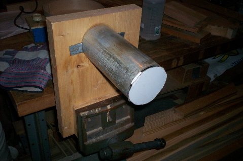

My bender is a piece of 3" (3.5"? I'm not home to measure) dia
electrical conduit I picked up for nada from a commercial electrical
contractor, cut to about 10" long. I cut the one end w/two tabs
which I bent outwards and screwed them to a piece of 2 x 8 with a
hole in it. I mounted a 200 W lightbulb inside connected to a
dimmer and fashioned a sheetmetal "plug" for the end. I'll see about
a pic if you are interested.

Sorry I'm a little late on this, but here are some pics from my
bending trek last night: front, back, and control views, and a shot of
the finished product from the session (my 1st attempt at a
mandolin...flattop w/back and sides of birch ply and top from a
sweet sounding 2x10.)
I hope this helps those who are visual learners. (I'm also a HS teacher
God bless
KerryLanceK38806.5971990741

Kerry -
it seemed your image link was broken so i fixed it

[QUOTE=Kerapp]
Kerry, I take it you don't have any problems with the heat damaging the
brass socket?
Jay

Jay:
No problems at this point.
