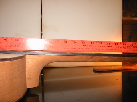

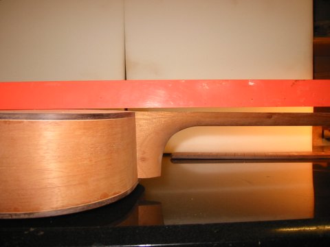

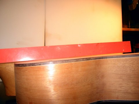

OK, here are some more pics and description of issue at hand:
The above picture shows angle where straight edge is resting on soundboard

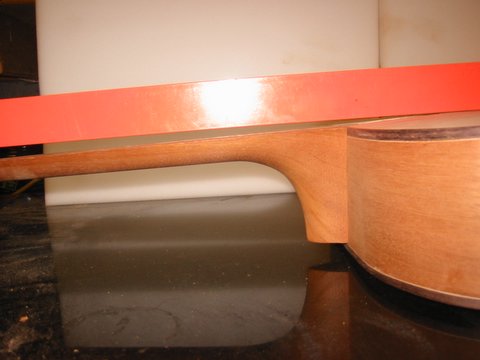

In the above shot, the straight edge is resting on neck. You can see that the soundhole area is actually distorting the actual angle. If the soundhole were flat, the straight edge would be closer to the soundboard where the bridge is located.
Above: this is a view with the bridge in place and the straight edge resting on top of the bridge
Another shot of the neck bolted on and flush with the soundboard. Straight edge resting on the soundboard near the bridge area.
Now as I said before, it looks like I have to raise the headstock or front of the neck by shaving the top of the heal closest to the soundboard which will improve the neck angle but worsen the gap in the fretboard.

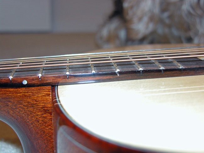

Also, I clamped the fretboard alone to the top and run the stright edge from the bridge across the fret board and this confirms a pretty good gap between the front of the body and the fretboard, but also then a gap between the fretboard and the neck.
Hope this helps clarify.

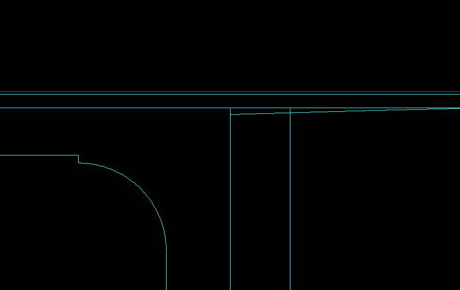

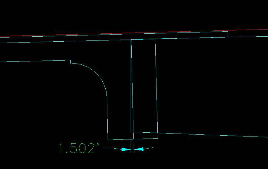

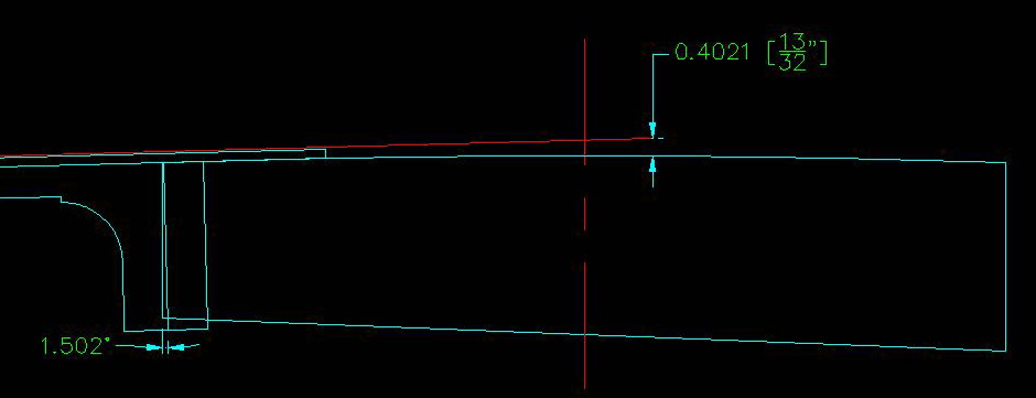

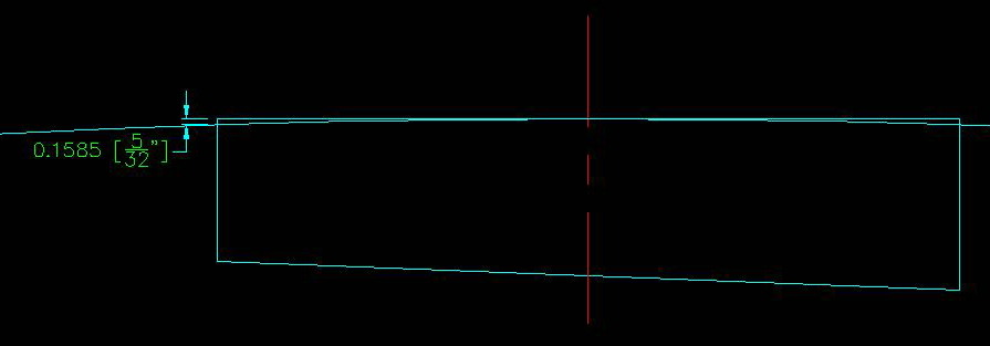

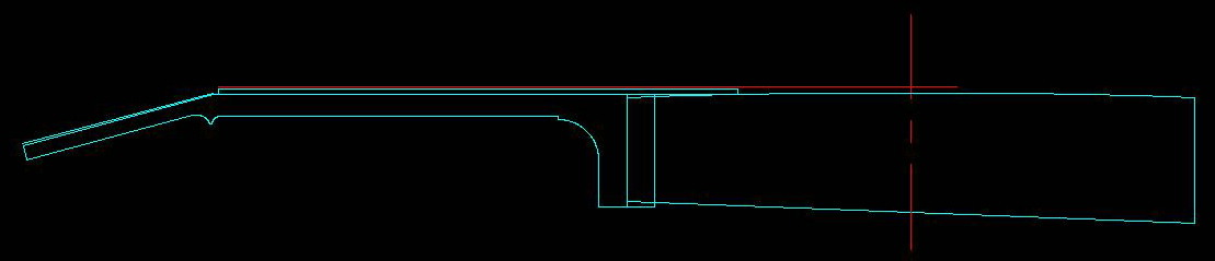

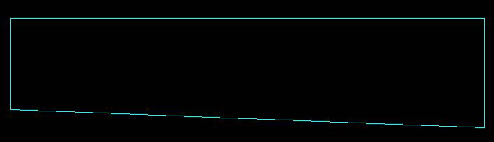

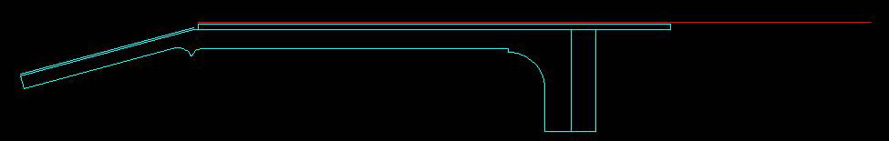

Thanks for the complements Hesh. I always lay out my builds in Autocad (I have a very funny story to tell about this some othertime). To me, it helps eliminate the posiblilty of problems. But this works for me, and maybe not for everyone else.
Here's a little reminder tutorial for those that may find it usefull.
So, I will draw out the front and tail edge of the body, than draw a straight line between them.
Next I draw in the 25' radius (I don't use this buy there are many that do so I will encorporate it)
Notice that it is at the very center of the body and that the gap between the "flat" line of the top and the curve is 5/32" which is greater than Rich's 1/8"+/- gap.

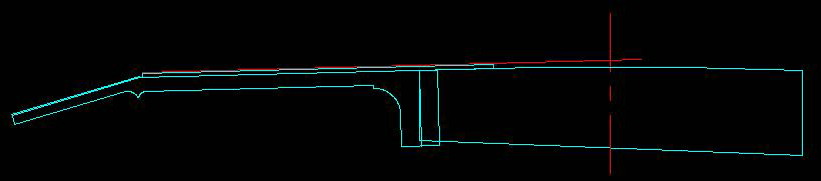

So now we take the neck layout. The red line represents our 25.4 scale at the top of the frets.
And we lay it out on the body which is sanded to 25' radius.
And of course we have our gap just like Rich's
Now we set the neck by shaving the heel.
And here is the angle we need to trim off the heal (Look familiar anyone)
Now here is the height at the bridge that we are looking for, maybe even a bit low (by about 1/32")
So this shows why 25' radius has been used to set the neck for a 3/8" bridge height.
Hope this helps someone, it helped me remember just by doing this.
Cheers All.

You da man Rod. You must be an engineer??? I see your point and understand it. In this case, if I shave the base are of the heel I think my height off the soundboard will be much higher than the bridge. Also seems like I will get a significant slope on the fret board from the 14th fret to the end of the board with as much as I would have to remove. Let's see what the others think as well. I am going to print your cad drawings and keep them for future reference. Excellent!!
