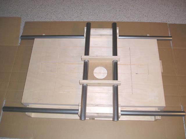

I designed a thicknessing jig that is used with a router...fast and easy for a monotonous task, no worry about changing belts or sanders bogging down.

That's very cool CT.
I assume the channels are for vacuum to hold the plates flat?
PostPosted: Sat Mar 18, 2006 11:20 pm
That is very clever, especially for those with small shops! Thanks Craig!

I learned from CT Holden that the channels are indeed for vacuum to hold the workpiece, and that it uses an ordinary Shop Vac, which is a really nice touch, everyones got a Shop Vac. He said any router with a 6" base will work. This is an interesting looking thicknessing jig. Has anyone used one? I'd love to hear some reviews. I saw some plans to build something similar on a woodworking site, but I'm too lazy to build stuff, and it takes some special talent, and extra effort. I'd rather spend a few more $$'s for something already built, if it works.
