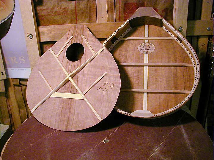

I'm very interested in your flat top design with the traditional bridge & tailpiece. Graham seemed pretty much convinced that a flat top would collapse, but yours seems to be holding up just fine. If I understood your previous post, you use a simple X brace pattern with no fans or bars... Correct?
Can you pass along the dimensions of the X braces & how you shaped them? Got a pic you can post?
I like the look of the bridge & tailpiece... And it would simplify the construction quite a bit.
Dave; your zook is a real inspiration. A beautiful & unique looking instrument. Is that a double X braced back? Or is it ladder braced in the lower bout?
So many possibilities, so little time... Sigh...
Thanks for starting this thread Tracy!

No it's one X with ladder at top and bottom:

That looks great, Dave. Solid neck block!
Here's a picture of the insides of one of mine. It's a redwood top, and Koa back and sides. The braces are 1/4", they are tapered.
As long as you don't use too much down-force on the top by using too steep of a neck angle, the tops hold up just fine. I make my bridge 1/2" high without a saddle- and I make it so the fingerboard with a straightedge along it will just meet the top of that bridge. Then adding the saddle will give me the action I want. I use a bridge with a slot for the saddle to sit in and I can use an under-saddle pickup that way.
Mark Swanson
