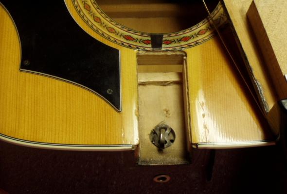

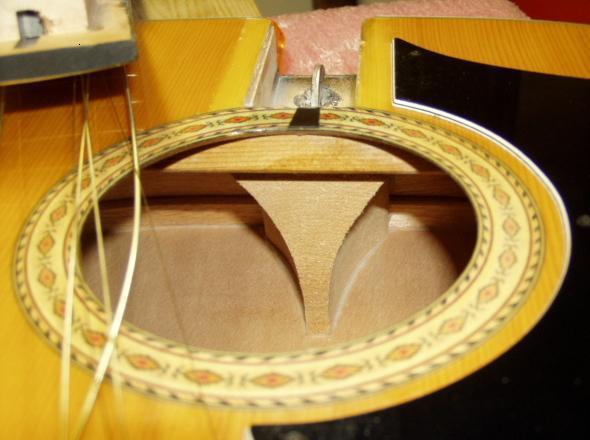

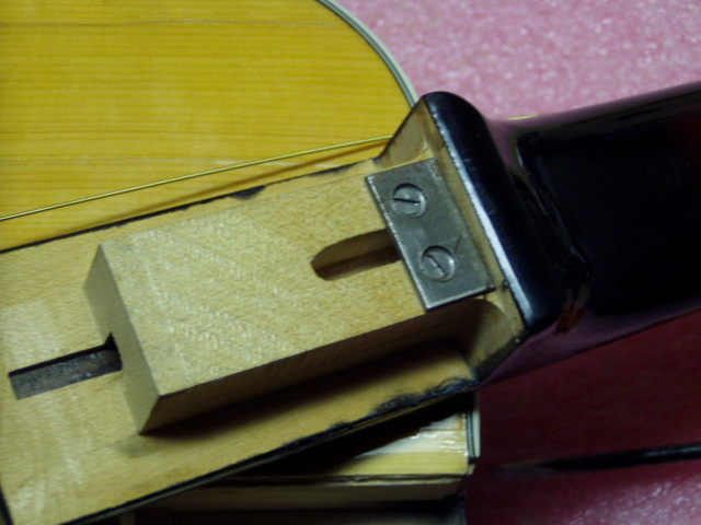

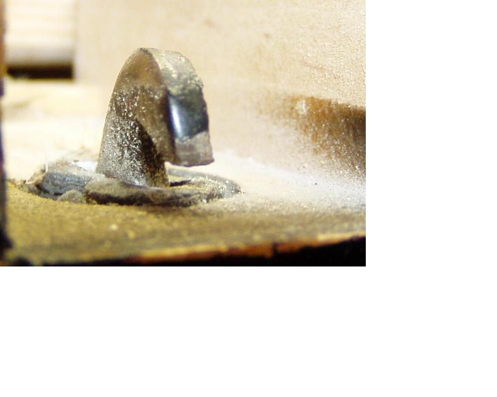

heres those photos of the hofner. It is easier to adjust without tension, a little is good, and since it does pivot the neck it does change the tuning. It does also make it very easy to remove the neck.I think it could be used different then I do, meaning a shim could be installed under it and then it could be tightened on the shim for a better fit. Anyway here they are, any questions just ask,,
notice the far left of the neck tenon, it appears to be compressed slightly. I believe this is the pivot for the neck.
The neck tenon pivots on the raised wood in the back of the pocket and is pulled down by the hook.
the locke ness monster,, oh sorry wrong photo thats the hook. Hope these give you guys some ideas what to do or not to do.. Mike

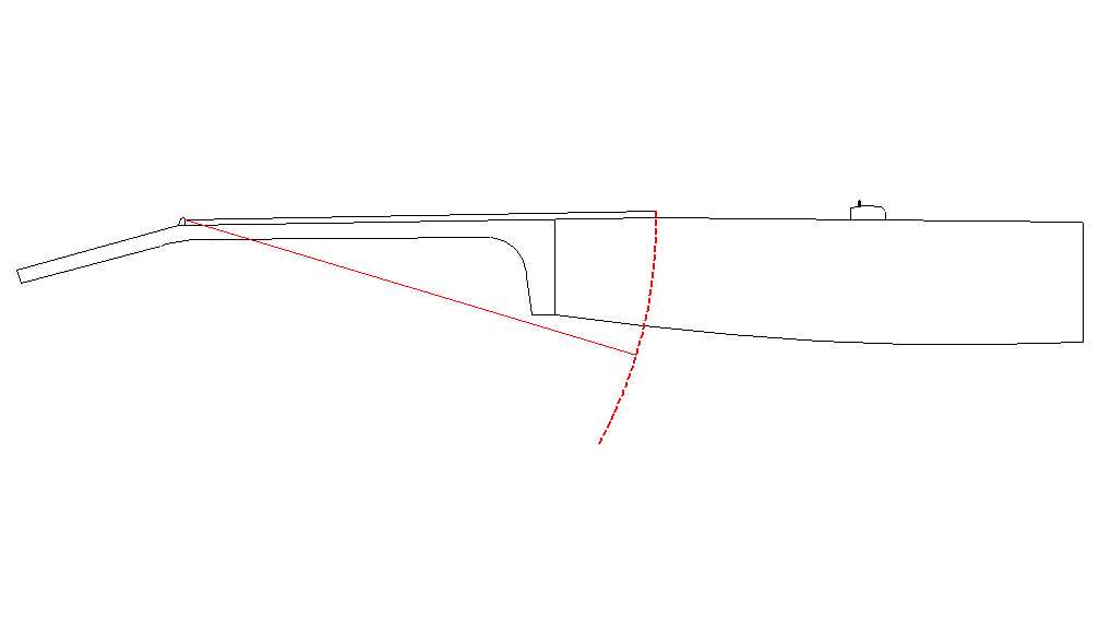

I believe this is a basic illustration of what you're after. I've had this knocking around inside my head for months now, but it is something I've got to try at least once.
Dave and John, So, you're saying that even with the scale unchanged ( the nut being the fulcrum point in this design ), that the change in string height will still change the intonation because difference will be in the contact point at the frets?
DES - Farwell, MI

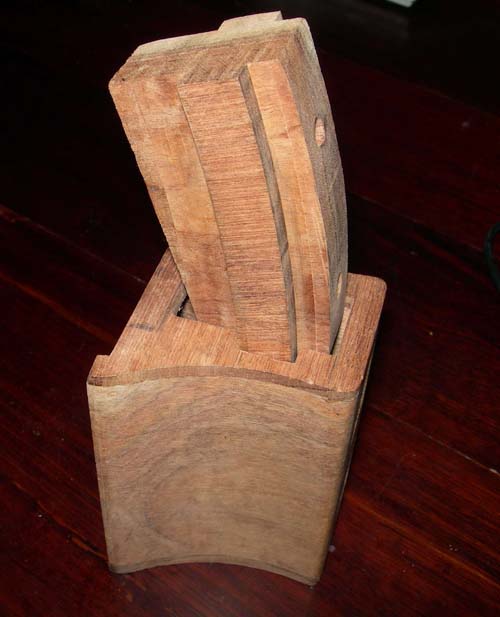

PostPosted: Fri Mar 10, 2006 7:02 pm
Posts: 228
Darin,
Your image is exactly what I was attempting to describe with words.The attached image is a neck housing block I was working on. I had a independent block sliding within the housing which bolted onto the neck but I figured that an intermediate compenent increased the chances of neck distortion/deflection and may have adversely affected the sound. It is not elegant or well machined but it enabled me to test the theory.Incorporating truss rod and action height adjustment caused me to pause and reflect at its complexity. I should have my next version assembled soon. Of course being the devil's advocate I have asked myself the question "Will the intonation variation produced by a greater or lesser action height make the adjustable neck pointless?"
Tim
Perth, Australia    Black Swan38787.1520949074

PostPosted: Sat Mar 11, 2006 2:47 am
Posts: 228
Good question
Weight is an interesting point. I am anticpating that the next neck assembly would weigh in at 150 grams. A mechanism for securing the slides might add another 20 or 30 grams. For strength I think I will have to form my own laminations.
Tim

PostPosted: Sat Mar 11, 2006 5:10 pm
Serge, it is amazing, I still struggle with setting a dovetail joint and getting the neck straight, this is well above my head, but this is how we learn the finer things in building. Mind overload on this one!
