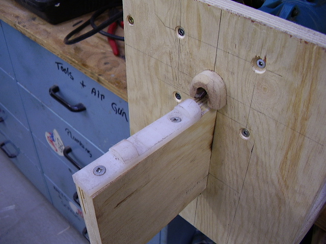

The Williams jig (inspired by Harry Fleishman's famous rig) is a really good thing. I built mine in a day & the cost was very reasonable.
Some good plywood, a 10 or 12" lazy susan (I forget which)& a set of industrial drawer slides is all you need... Oh yeah, you'll need a decent tablesaw.
I used 1/4" Lexan scraps for the laminate trimmer mount section & 3/4" aluminum square stock with spacers between for the articulated head.
Don has very good pics & instructions on his website.
For anyone planning to build more than a few instruments, I highly recommend it!

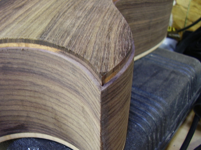

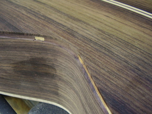

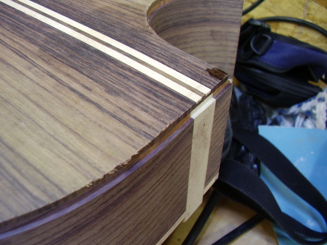

So, It took a while, but I finaly cut the binding ledge tonight and thought I would post the results.
I cut a few test pieces on the flat, but there I don't have any curved pieces to test on, so.... to the back I went. And let me tell you, it was simple, easy. Worked like a charm.
I did make a few modifications as per some responses to the post and hot diggidy, it worked well.
I watched the Taylor factory friday binding video a couple of times as the "user guide" and noticed a few things that helped gain confidence that I could do it. And It worked (I think I may have mentioned that).
So, here are the pics.
Thanks for looking.

Very nice Rod!
Great looking guitar.

Looks great, Rod! I'm glad to see more people in the "fixed router camp" getting good results...

Wow Rod, i'm glad everything worked out fine for you buddy!
Beautiful cutaway too!
