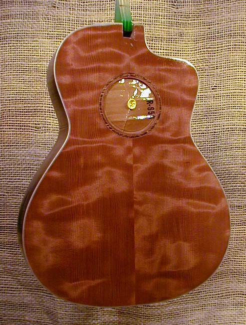

I've gotten a few tops from Bruce Harvie (here known as Spruce) a few years back. I've built a few guitars with them, octave mandolins, too. In fact all of the redwood that I have ever built with comes from this batch I got from him. So anything redwood on my website is wood I got from Bruce...
And I happen to be finishing a redwood/walnut L-00 right now, here's a shot for you. I used amber shellac on the top before the lacquer, I love the warm color. One of the checks that Bruce mentioned popped up on this top, but I used it anyway! I made sure that it'll be under the pickguard, if you look closely you might be able to see it. Oh, the Fatboy Guitar that I use for my avatar is also that same redwood.

I really like the green neck on this one, a little thin but a nice contrast.

Mark that guitar looks beautiful as does al your work.

Hesh,
That thing looks great. It'll be a killer under finish.

I love it when curly redwood "chevrons" like that...
Beautiful wood....
Is that an old Twin or a Re-ish?
PostPosted: Sun Jan 08, 2006 11:13 am
Great lookin' top Hesh, i'd love to seeit too when finished!

Hesh,
That looks great. So, what thickness did you make the top? Let us know how it sounds.
PostPosted: Mon Jan 09, 2006 2:17 am
Hesh, beautiful guitar! Is is built from the JS plans available here on the OLF?

I can understand the doubts that Howard talks about, and I do wonder about them. But the funny thing is, I have never had one of these tops fail, but I have had other tops fail on me.
I have thought about the runout. And I think that these tops remain strong because the runout is so very short through each curl, and not like one wave or curl that might spread out over 6-8" of top. Something about the way it is distributed across the top may help it stay strong...I don't know for sure but there must be a reason for it. I don't think I have ever heard of anyone having one of these tops fail for that reason, now that I think of it. Mark Swanson38726.4388888889

Thanks for the info Hesh. I am ordering a set of OM plans as well, along with the Woolson neck jig plan. I have the SJ plans and thought your guitar looked like them, but looking at plans and looking at the finished product can sometimes be deceiving.
Great job, looking forward to seeing it with finish!
