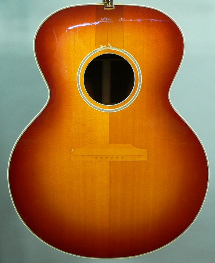

Yes, That is the Zeidler Project guitar.
The Color is U.S. Cellulose Yellow MEK DYE. It's nasty stuff but it's the best. I drop it is McFadden Clear and mix it up. They make a ton of colors and if you mix them you can get a ton more. Anyone that wants more info feel free to Private Messenger me anytime.

PostPosted: Mon Sep 26, 2005 11:00 am
Posts: 908
Holy Mother of OTIS!!
(OTIS being "Order of The Immaculate Sunburst")
What's the base color for that one? Oy, that is lovely....
If you don't mind telling us more on this dye, may as well do it in public, so that everyone learns. Can you start a thread when you get a chance? Is it similar to the universal dyes used to mix auto colors?

I will get some info and some photos of the products together and post them this week. Some day I should make a Mayes Style DVD on how I do a burst. Because its as much about how you spray a burst.
The Color is only half of it.

Well, I'm really beginning to see why so many great builders send their stuff to Adam for the finish. Dang, that's the nicest burst I've seen yet. Incredible colors, and the transition is beautifully subtle. Perfect. Sign me up for that dvd!

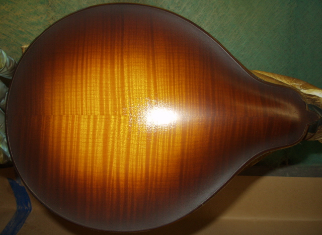

PostPosted: Tue Sep 27, 2005 2:43 pm
Joined: Tue Sep 06, 2005 8:03 am
Posts: 83
Hey this mando is still going, it's dark,like the guy wants, but you can still see the wood. It has no clear in the photo. only color.
