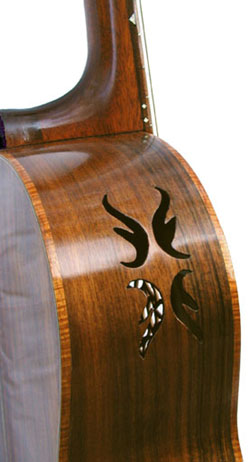

Here's a soundport pic from my 1st attempt.
It's easy to draw or print from computer onto paper, glue the paper on, & drill and/or cutout.
Currently working on 2nd guitar with soundport in contrasting Sapele & Maple design - layered

Skip, that looks great! I'd like to see your next one.

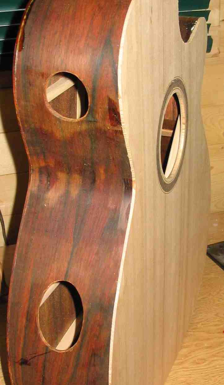

Here are some of mine
I have only completed on instrument with the side sound port. The sound was amazing! So amazing that I am offering the port as a standard feature on my deluxe guitars.

Steve... ha, I don't know about a mudflap girl. A skull and crossbones sound port doesn't fit my guitars one bit either, but I'm doing a european maple guitar for myself, and it'd be a fun touch. Maybe I'll come up with something I won't have to explain to everyone though.

Josh--What kind of wood is that? If someone put a gun to my head and made me guess, I'd say Bois de Rose.

I was looking at what Skip did with his,(Looks Good Skip) and it is along the lines I have been thinking on design.

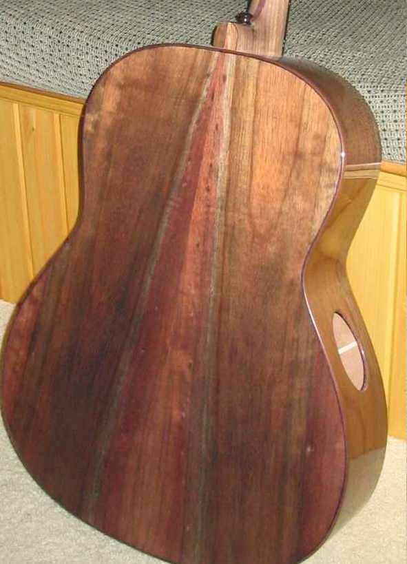

Al's side port guitar.
Looks like something someone would bring to a frat party. Sort of like a wine sampler.
BTW, This guitar is one of the ugliest guitars I've ever seen, but it sounds pretty good. My favorite position for the side port turned out to be where most builders are already putting one. I suspect luthers develop a sense for acoustics and automatically gravitate toward things that work better.
