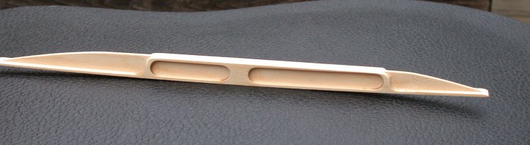

Yes, I have pictures of it at work, Ill post them tomorrow. I know Kevin routed a channel all the way around the top about 1" in from the end, and the braves are all routed in an I beam fashion. Kevin also holds a patent on the end block which supports the area that the stings attach with out touching the top. If you look closely you can see a support coming up from under it.

No pictures of the bracing pattern, but here's one of his I-beam braces.
