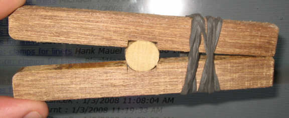

You could make your own like this.
Control the clamping force by how many times you wrap the rubber band.
Control the opening width with the depth of the dowel channel.
Make them wide or narrow as you need.

bruce, those are sweet. very simple and i bet they work like a champ. i just ordered 100 of the mini spring clamps in my original post. ill let you know how they work!
