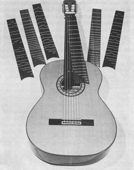

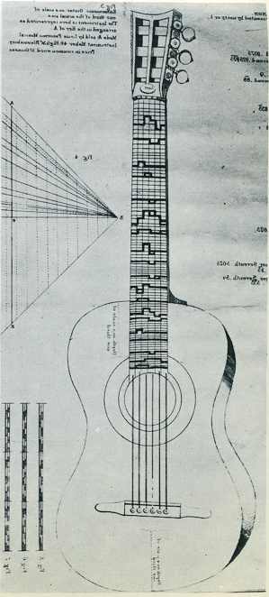

For those not familiar with Tom's system, at least it allowed for
interchangeable fingerboards for different keys or temperaments.
There have been ample systems of similar intentions, most well known
probably being General Perronet Thompson's, from nearly 200 years ago.
Neither of these ever really took off.....

I made a new fingerboard and tied movable frets on a Yamaha classical guitar for Ramin Torkian, a Persian customer of mine in LA. He had me put on 24 frets to the octave, and to tie them on over the heel, I drilled holes clear through the neck and heel. I nipped and filed off the tangs on the biggest Dunlop frets I could get, and filed little notches on the tops of the ends of the frets to catch the fret gut loops. This is basically how sitar frets are tied on, and I just adapted it for guitar.
My door was not beaten down by legions of other guitarists, nor did I expect it to be. Great art project, and I got well paid for what I did, and the customer was delighted.

I have a number of viola da gamba players that I retie frets for occasionally.
One difference between beginners and more advanced players is that for
early students I tie the frets rather firmly so as to not shift, while more
advanced players prefer their frets tied just loose enough to be movable at
will, so they can temper certain intervals for different pieces.
