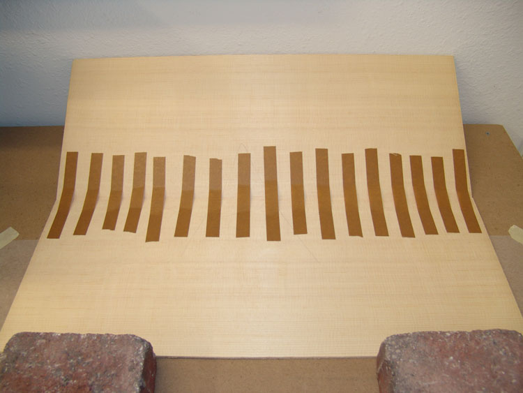

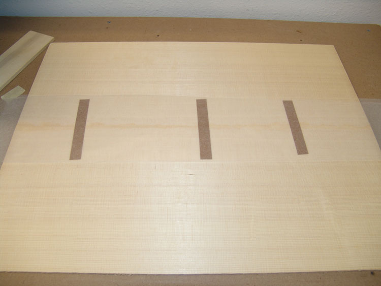

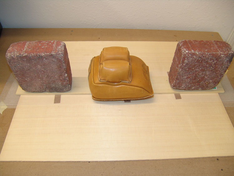

So I got out my genuine Todd Stock reconditioned Record #5 and wham, bam with about 20 strokes (the edges were very rough) and stuck it in the window to candle it.  Low and behold this is the first time I got it right on the first go - no gaps!!!!!!!
Seizing the positive momentum I'll let the pics tell the rest of the story:
This is what the squirrel claw top is going on.
And out comes the Stew-Mac brown tape.
Wipe up the HHG squeeze out.
Waxed paper on top.
And some high-tech, NASA approved, Mil-spec pressure application apparatus.
Whew - I'm tired now but happy.
Many thanks for everyone's very valued help!!!!
