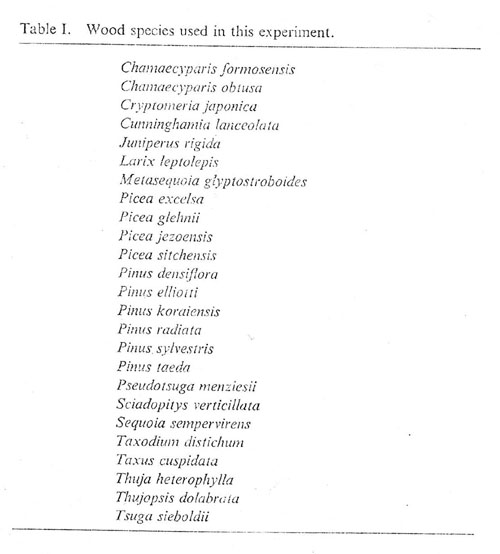

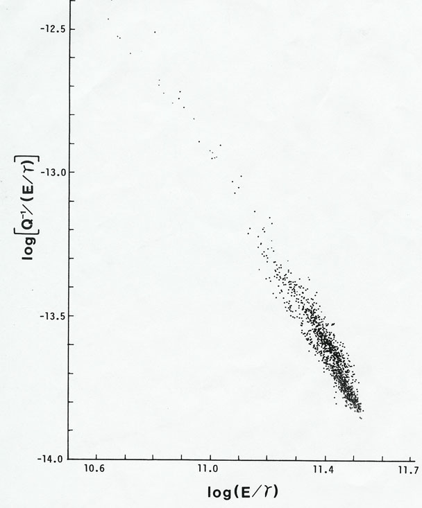

Here are some data from one of the articles I dug up:
The data are from Teruaki Ono and Misato Norimoto, "Study on Young's Modulus and Internal Friction of Wood in Relation to the Evaluation of Wood for Musical Instruments," Japanese Journal of Applied Physics, 22(4), 611-614 (1984).
In the above plot, 1/Q is a measurement of "internal friction," which is equivalent to the loss tangent, measured over the frequency range of 250-700 Hz.  E is the Young's modulus, and the symbol gamma indicates the specific gravity, which is a unitless measure of density.  In general, a lower value of Q resulted in qualitatively more sonorous piano soundboards, and this value tended to decrease in softwoods as the specific elastic modulus of the wood increased.  The differences in specific modulus were correlated with microfibril angle in the secondary wall structure of the wood cells.  Internal friction decreased as the microfibrils became more longitudinally aligned.
