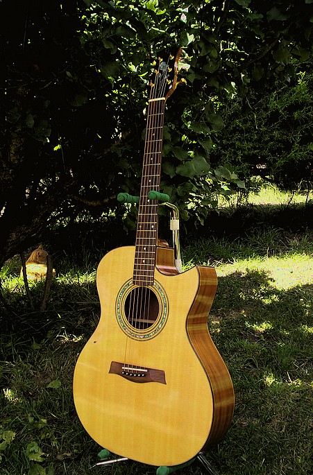

Jim, I thought about the bridge a great deal before going ahead with the shared pin method. I've restrung enough 12's to be annoyed with the 12 pin set up. Every thing seems too cramped , and your strings often nudge other pins. To replace a string , you sometimes have to remove another pin , and that's if you CAN remove the pin . I also wanted to get away from having 12 holes drilled in this important area.
I saw Dave white and Howard Klepper use this system, and after some of their advice ,was sold on the idea.
All of us have used the Stewmac oversize pins . There is enough room and the strings seat themselves nicely.
It also allowed me to reduce the size/weight/footprint of a normal 12 pin bridge. I could also get the string spacing where I wanted it and not be dictated by the width of the bridge pins

                  The liners are a Charles Fox idea. A two piece arrangement , whereby the ( Walnut ) kerfed part is glued on first. This part has a rebate to fit the ( Tas. Sassafrass) strip flush, which is glued on as a second operation . It makes the rims very stiff and a nice solid area to glue on the plates and hopefully contain most of their energy. The sides are .1 " thick for the same reason

Yes ,I use locating pins for the top and the back. Just ensures them to be glued in the exact correct spot and takes that issue away when your rushing to get the glue-up done while the stuff is fresh.
Actually ,a fair bit of the inside detail is noticed through the soundport. I find people delight in peeping inside.

I made the neck a bit wider at 1 15/16 " for a little more space between all those strings and am pleased I did. It's a total bolt on with carbon fibre rods and a two way rod
The body is 4 5/8 " at the tail
CRAIG LAWRENCE of AUSTRALIA

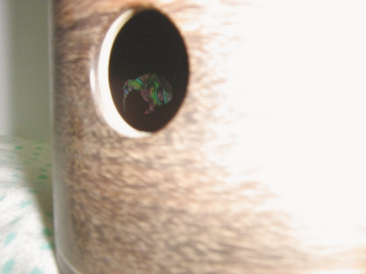

Here's a shot of my little Paua Kiwi inlaid into the neck block , viewable through the soundport
PostPosted: Thu Oct 11, 2007 10:06 am
Dang #3 ! ! ! !
I'm just so floored with this one, and I was floored with your #1 as well. Everything about it exudes class and style. The laminated/purfled side braces, the Kiwi on the neckblock, the broken inlaid "purfling" on the neck, bridge, and headstock are too cool for words. Everything about this is expertly fitted and tastefully done. If I didn't know better, Id swear your last name was really Kinnaird or Klepper! I'm not sure how you can raise the bar any higher than you have, certainly I know of nobody's first and second instruments that I can put at this level. If it sounds as good and plays as good as it looks, it's a total winner.
