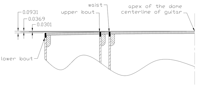

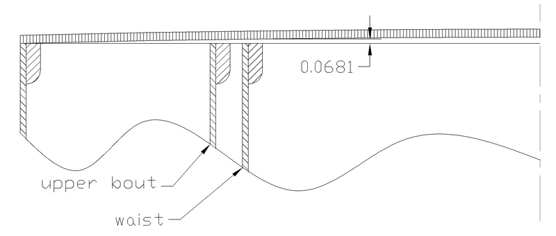

I suspect most people's unexpected issue when binding is not understanding that the elevation profile of the domed top is different all the way around the guitar.
If you could take 3 MRIs of the guitar, one at apex of the Lower bout, Upper bout and Waist valley this change of elevation is evident
Dealing with this some times make one over think. Truth is the binding gives this much with no issue.
However if you router is indexing the top and not the sides then the angle of the channel can change dramatically as you go around the guitar. That is why you want the binding channel indexing off the sides for angle of cut and only off the nearest possible point to the channel on the top for depth only.

For any of you that leave your top un-profiled to match the proper intersection of the dome. you are having to pull the top out of shape a bit more than 1/16" at the waist to make contact with your linings. That is of course if you keep the rim edge and linings all in one flat plane. If you pre conture the top of the rim to account for the arch then it is not as big of an issue. but if you dont sand it in then how do you map it out?
If all of the top rim and lining is in on single horizontal plane you are spring loading the braces a good bit and building in tension that is constantly trying to relive it self.

Guys I never said it was a guaranteed fail. I only said the geometry shows that by doing a straight top rim with a dome top that the builder imparts built in stress. on the glue joint.

The dome is one constant radius or sphereical segment, but because the shape of the body is not one common width or the same distance from the center of the dome everywhere, the intersection of the body with the dome has an ever changing elevation. The closer to the center of the dome the taller the side profile. The further from the center of the dome the shorter the side profile.
