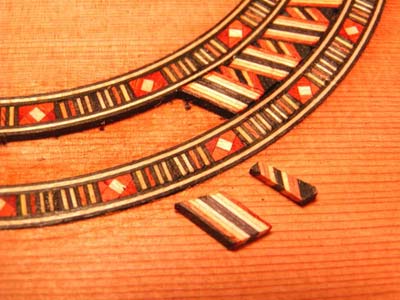

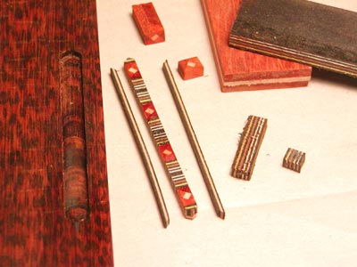

Mike: The central DNA double helix motif is my tribute to biochemistry, my field of training. It is composed of two tiles, one for the front of the helix and another for the back. The tiles are cut from logs made from stacked veneers and plates of ebony (for the larger black areas). The front pleat is cut with a chisel to the shape of a parallelogram, while the back pleat is laboriously cut in the oblique shape shown in the first photo below. I always strive for side grain on the faces for maximum sparkle. The white maple diamonds within the red padauk rectangles are tiles from logs made from maple sticks (approximately square in cross-section) that are encased in padauk sticks. The assembly is turned 45 degrees to transform the square into a diamond, and then shaped into a rectangular log on a belt sander. The second photo shows the diamonds being readied for inlay into an end graft.
