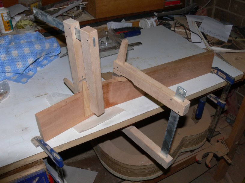

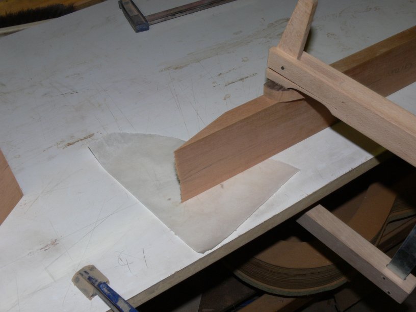

I use hide glue for this process.
Mainly because of its low slippage value.
I lock the neck to the workbench with clamps, using a square to make sure the neck is square to the workbench.
Dry fit the peg head and place clamps on the bench as slippage stops at both the headstock and heel end.
Peghead on mine goes onto the back of the neck, using lots of glue so as to not starve the joint.
Using silicon baking paper to stop the thing sticking to everythng else.
Once the glue has set a little I use one cam clamp on the joint just to keep things in place while it cures.
I like the cam clamps for the actual joint clamping because of their low torquing action -- less torque = less slippage.
Heres some pics:
Claire
