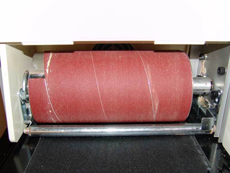

To tell you the truth, I'm really not sure about the direction of the winding. The spring paper tensioner is on the right hand side and the static clamp on the left. In order to have the paper end up in the spring side, you have to start at the left. Does anyone with the 16/32 have any input on this?? Hesh may be onto somehting here but I waqnt to make sure...
I have watched the video that came with the machine several times, and they areally dont go into detail on wrapping the paper except that the end of the roll should end up with the spring tensioner side.
That still doesnt mean that I couldnt wrap it in the opposite direction. When I tried wrapping it backwards to what I have now, the paper tears rather quickly right at the bend in the paper where it goes into the clamps. I tore several rolls of paper quickly like that before Iwent to this method. I'm not tearing paper any more, but the paper doesnt seem to last long even when I am sanding tops with it.
I'm really pleased with the sander. It is a well thought out machine and VERY accurate too. This is my first try at sanding maple but I have noticed the burning even with sycamore. I have some osage orange that will go through the sander soon and knowing how dense this stuff is I expect that a wrap of the current paper I am using wont even do a back and sides set. I'll definitely try some 80 grit and possibly some 60 grit papers just to see if this helps with the problems I'm having.
I notice that there are several types of paper also. Some of it is paper backed, some cloth backed and some of it is cotton backed. The paper I am using is cloth backed and it does seem to stretch quite a bit during use. Event he spring tensioner cant seem to keep the belt tight enough without re-adjusting it at times. Would one of the other kinds of backing be better than cloth?

A problem I've had with tops or backs jointed with titebond is the formation of a streak of glue on the paper, very much like the one on the left edge of the drum in Hesh's picture. If you don't pick it off with an exacto or high pressure air it builds then begins to burn a streak in the wood. Doesn't seem to occur with hide glue.

[QUOTE=Hesh1956] That's interesting Marc and a good argument for me to start using HHG to join plates. Thanks!
Looking at the picture of the clamp above is very telling about how the range finders on digital cameras work. Since it uses sonar it measured the distance to the surface of the mirror, not the distance to the image reflected in the mirror. Just an observation here.[/QUOTE]
Yeah, but what a great camera Hesh, you can count the grit on the drum it is soo clearly focused.

Ken, I have the 16-32, I wound it backwards at first and tore a roll. I don't think the paper being wound in one direction or another should matter as far as your gumming problem goes. I think the direction of the winding only matters in getting the max life out of your paper. I have never used 120 grit, and really think that is your main problem. I like the 36 grit or 80 grit only.

Ken, it didn't occur to me before but I went back and looked at the pics and you indeed do have it wound backwards. If you are standing at the infeed side of the machine, you'll want the roll to fall at your feet when you clip it in the "static" clip. Then roll the drum away from you to make the wraps.
This said, I'm not sure it matters with the burning and loading. It is however sort of a safety issue. You want the winds to be going in the same direction as the drum spins so that they sort of tighten as it spins. If the winds go the other direction, the pull will constantly want to rip it out of the clips. If it does the whole thing will unwind and it could be a potentially dangerous situation. I once had some 36 grit on mine when it literally blew up. (the belt I mean) It blew the cover off the machine and started sending pieces of 36 grit shrapnel flying around the shop. As well as half of a belt still attached to one clip spinning at what ever the speed was and hitting the machine every time around. Trust me, that's a noise you don't want to ever hear first hand.

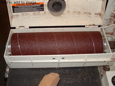

Hesh, Those pictures are great! I don't think I have ever caught a good look at that clip because it is kinda awkward to see. You motivated me to take a look at how I wind(especially because I do start at the sprung side, and it has given me no issues).
I realised that when I start winding I clip the paper(and this is on the sprung side) then I wind the drum once around(to get the paper alighned. I had ahold of the drum through the end with my thumb on the sand paper. When I straighten and snug the paper I noticed the I pulled the paper tight, it also pulled back on the spring. Then as I wind I keep the paper tight with my right hand as I guide the paper onto the drum with my left. When I get to the open end my right hand thumb is placed on the paper and I pinch the fixed clip open with my index finger. I feed the paper through the clip with my left hand, still holding the paper and clip with my right hand. I then grab the tip of the paper(It is easy to grab on the open end of the drum) and wiggle it to get it seated well and give it a good pull as I release the paper and clip with my right hand. After watching the spring side through the process, I noted that I never release tension on the spring(looking at the spring clip as best I could it looked like it may have slipped a bit, but was still tensioned). I also tried reversing the process and finishing on the sprung clip, but could never get the same tension(probably because I am just not used to doing it that way).
I took a picture of my drum. It has 60 grit on it right now. As memory serves, I surfaced approx 20 Spruce soundboards, 4 B/S sets of Koa, 2 B/S sets of Pink Ivory, 2 B/S sets of Myrtle, 2 B/S sets of Sapele. Surfaced Several set billets, 2 Snakewood Fretboards, and a handful of other things that are not coming to mind right now.

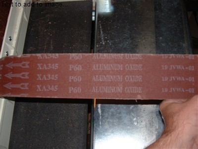

This is a shot of the back of the role(cloth backed Aluminum Ox). I don't know what brand the paper is, but it seems to do a good job.
