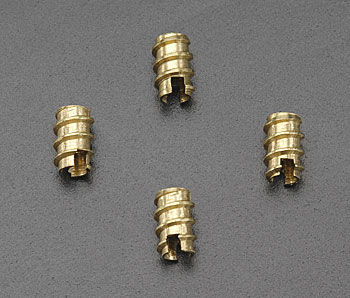

I used some brass inserts like the ones pictured for a project, and incorrectly assumed that the slot was for a screwdriver(IT IS NOT)
The insert should be held with a threaded screw and a nut on the plain end, and the slotted end inserted into the hole in the wood. The slot forms two cutting edges when the insert is turned into the wood via the screw and nut.

Good point Ray--I made that assumption too, but quickly found that a screwdriver did a great job of tearing up and cracking the insert and a lousy job of getting the insert into the hole!
The steel inserts I just tried have little holes in the side that serve the same purpose as the slot in the brass ones.

OK.  I did another test using the self tapping brass inserts as shown in Ray's picture--same test as I did earlier with the fine thread steel ones.  5/16" pilot hole for the brass inserts, slot side down.
Please note that a lot of the inserts that you find have the slot cut into an un-threaded part of the insert.  These are NOT self threading--they compress the wood like a wood screw does, and don't hold very well in hardwood from what I've seen.
Anyway, the self tapping brass inserts are a little bit harder to get coaxed into entering the hole absolutely straightly (I think that John's long installation tool would make life easier), but the coarser threads definitely hold better than the fine threads.  The brass stripped out before the wood gave way (same piece of bigleaf maple endgrain).  In fact, the wood never gave way with the brass insert.
I think that either insert will be plenty strong in maple, but the coarse thread brass I believe is the better option.  For for softer woods like mahogany, I think that the coarse threaded inserts would make even more difference.
Self tapping is the main thing though.  Those "thread forming" inserts just aren't very good in hardwood from what I can tell.  Tapping the threads and removing some wood instead of compressing the wood around the threads is just a lot stronger in hardwoods.
