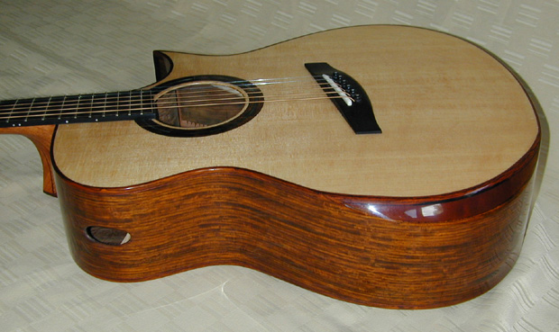

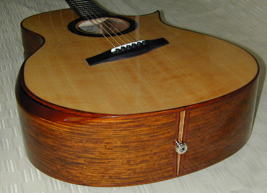

That ribrest seems to be the same color as the binding. Did you veneer that area?
PostPosted: Wed Jun 20, 2007 12:29 am
Ah .. no .. that one is a spanish cedar block, very brown braz B&S .. so I tinited the lac to that shade and sprayed the colour coat after getting the first 5 or 6 down, and then flat sanding them. Then shoot another 5-6 over it (and the rest of the body) and be careful not to sand/buff thru to the colour coat. I did the same on this one, the block is mild curl soft maple, and the B&S are coco, then sprayed the block to match in, as I didnt want it to stand out, but blend in.
