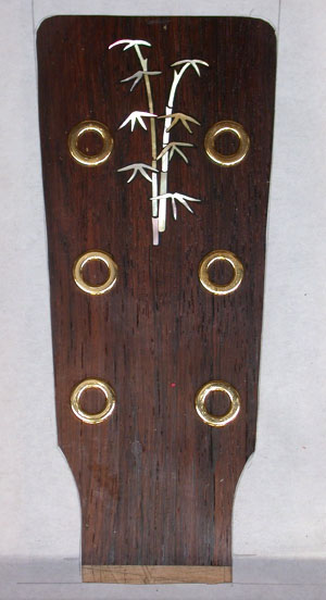

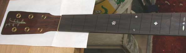

This is a mockup for #3, a koa 000. Body is closed up, just finished getting the plates to vibrate together ala Carruth, (with the expectation that the bridge will lower the top). Mad rose binding is next. Here I'm trying to see how the headstock and fb inlays are going to look together.
PostPosted: Thu Jun 07, 2007 7:00 am
like bambo

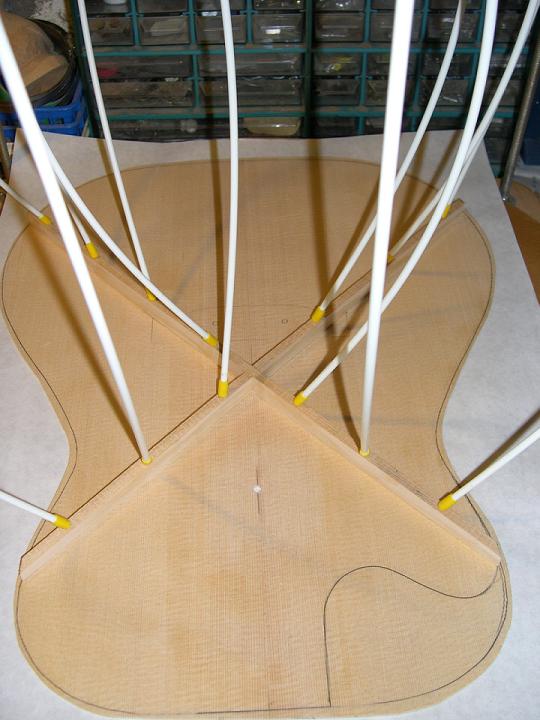

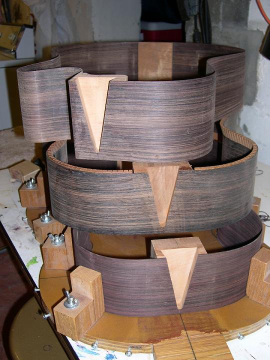

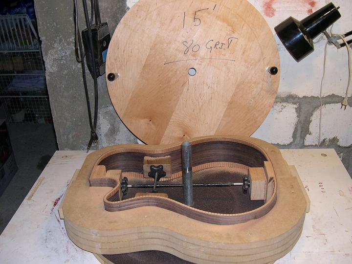

Currently 3 EIRW, one I'm helping my daughter's boyfriend build and two for family.
The cut-away is being back radius 15' by an idea presented here at the OLF. Much appreciated.
And last the x-brace going on the cut-away.
See the mistake?
I forgot to cut the sound hole before bracing.

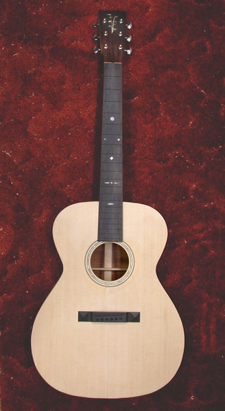

Here is a Honduran Rosewood 000 I'm working on.

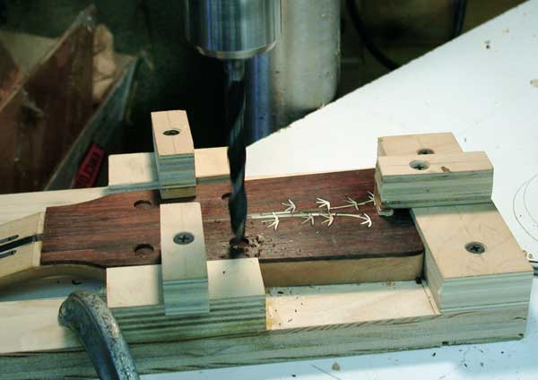

I wanted a more secure way to hold the neck while drilling tuner holes, so I came up with this jig.

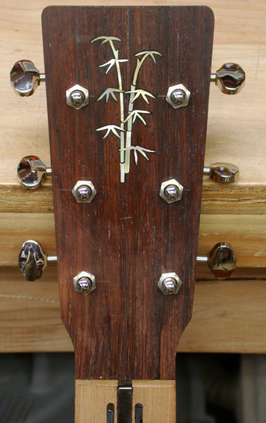

Now the hs looks like this, no finish yet, but a light wash around the inlay. First Waverlys. Sure are nice.

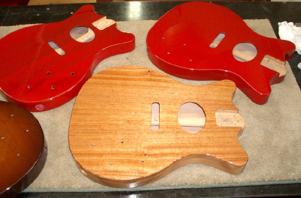

Nice thread!

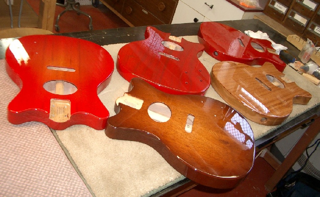

Here are the five bodys of the guitars I am preparing for the Montreal Jazz fest in three weeks...  the necks are also ready!!!  I am in good shape!

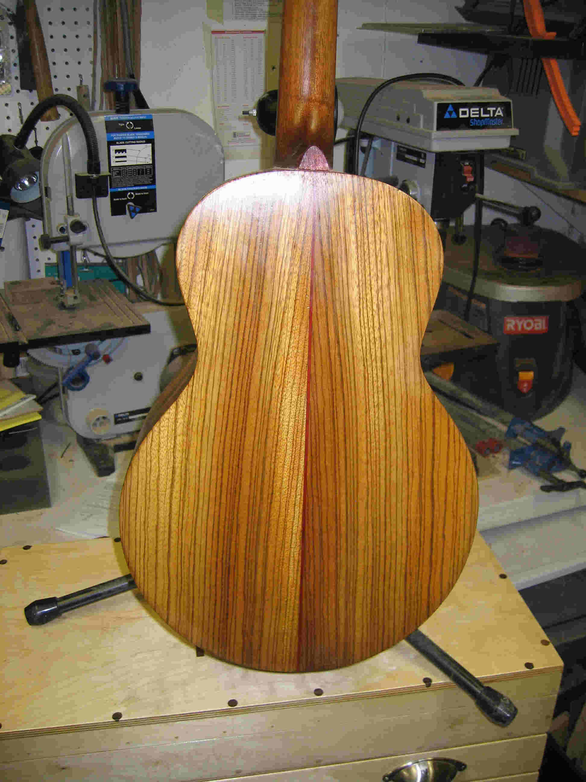

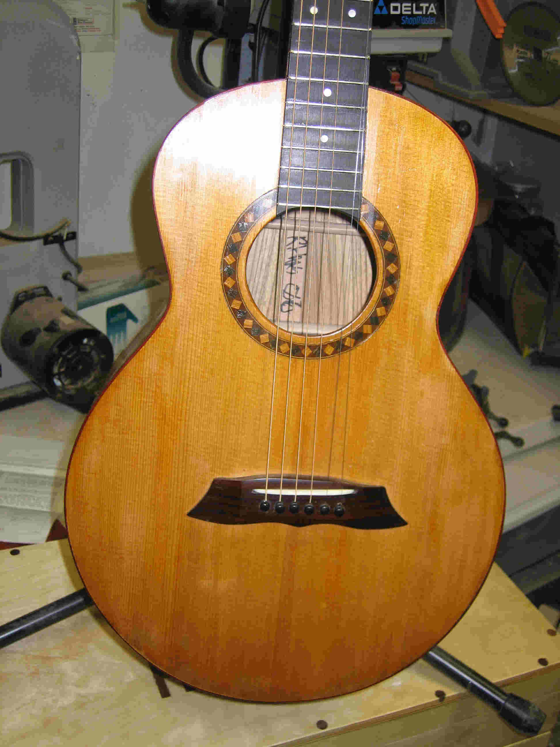

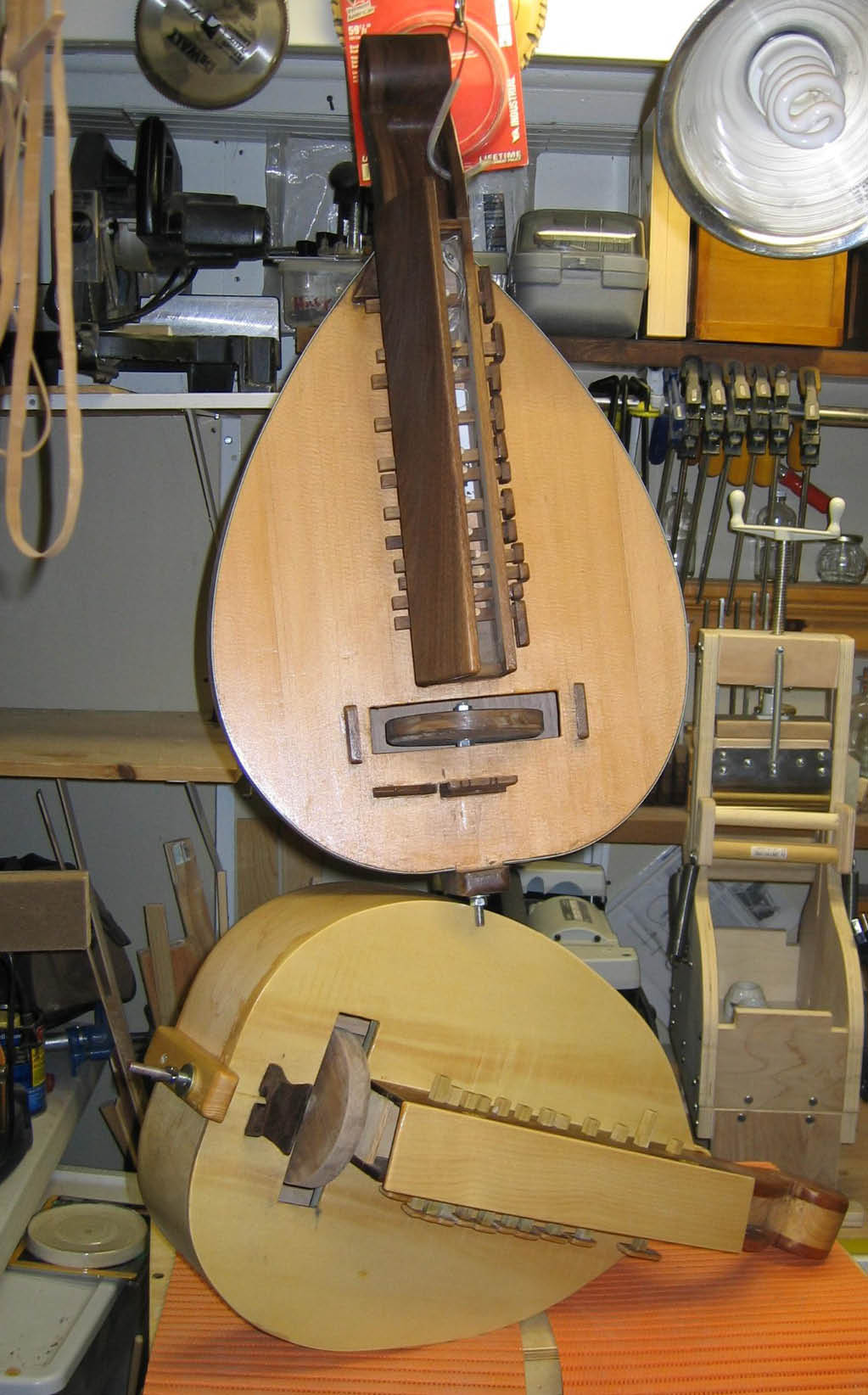

I am definately out of my league with all the fine crafstmanship posted
so far, but thought that my current  handywork might provide a
chuckle or two.
 The Zebrawood is handsome, and sounded pretty good until my premixed Hide Glue Failed!!!!!
PostPosted: Sat Jun 16, 2007 2:21 am
Love the Hurdy Gurdys.
