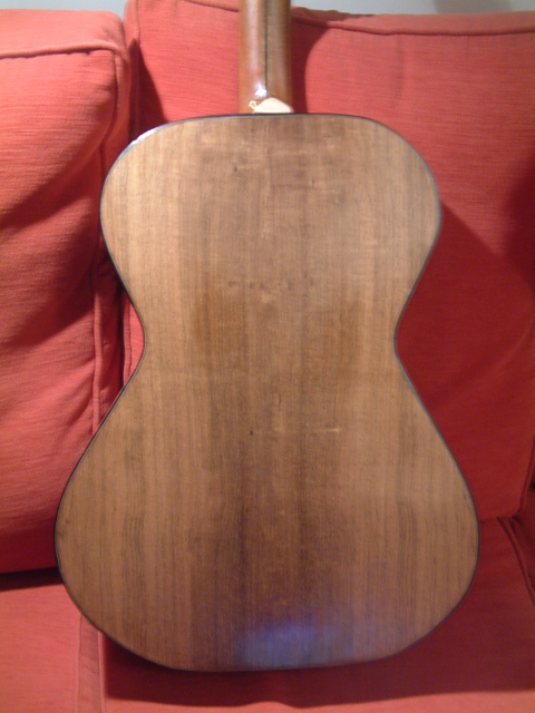

Thomas,
You mean dark like this?
That's Tru-oil on Braz Rosewood that has been on the guitar for three and half years.
I have done many guitars with a shellac (FP) finish topped off with Tru-oil coats and these have worked fine. As Michael says, shellac goes on Z-poxy and from my experience Tru-oil goes on shellac fine.
I haven't done Tru-oil over Z-poxy for b/s but I have for a neck on my most recent guitar and this is working just fine so I don't think this will be a problem for Barry. As Todd says Barry can test it out on scrap first. Or perhaps FP the b/s as well before applying the Tru-oil.

Dave,
Well, the proof is in the puddin' and it looks like you are using Tru-Oil as a topcoat over a dis-similar sealer with no problems. I guess I stand corrected. It still does not make sense to me, but that's nothing new.
