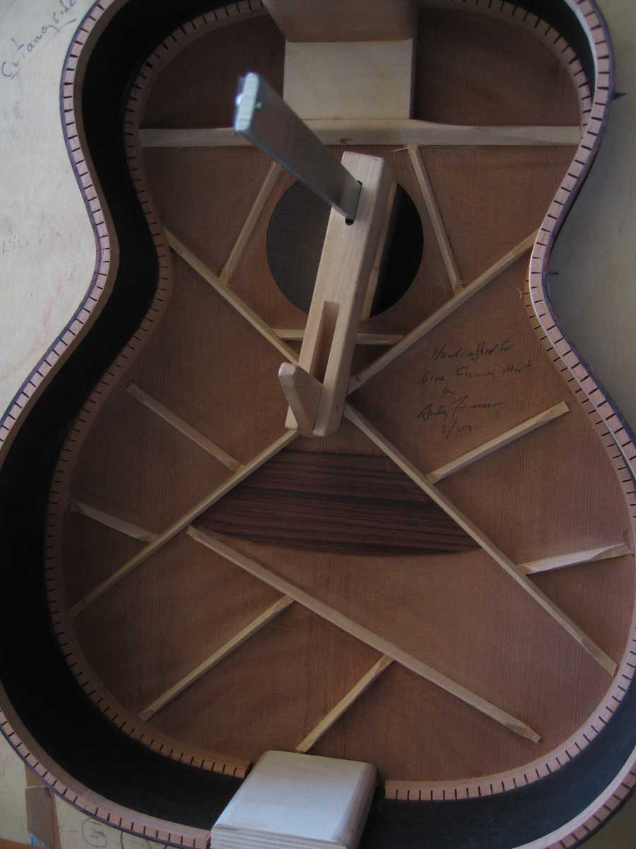

I'll show mine again
PostPosted: Sat Apr 28, 2007 7:31 am
The writing? or the Ping?
That's just True Guitars, my signature, #5-OM
PostPosted: Sat Apr 28, 2007 7:37 am
Thankyou Hesh.
Well, my regret is that I didn't install a small finger brace on the bass side of the X brace....and am wondering if I should glue a precarved one in JUST to fill that vulnerable area of spruce.

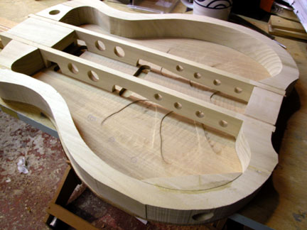

OK it’s not an acoustic but..
This is my attempt at making an electric 12 string that has “some” acoustical sound.
Not realy a brace pattern per say, but two hefty struts carry the string load through the body but leave the lower bout free to move (a little). I carved pockets into the top in a spider pattern. I’m not sure if this will do much but it does look cool.
With all the posts on light instruments, this is the lightest electric I’ve made.
Sure hope it sounds good.
Wade
Wade

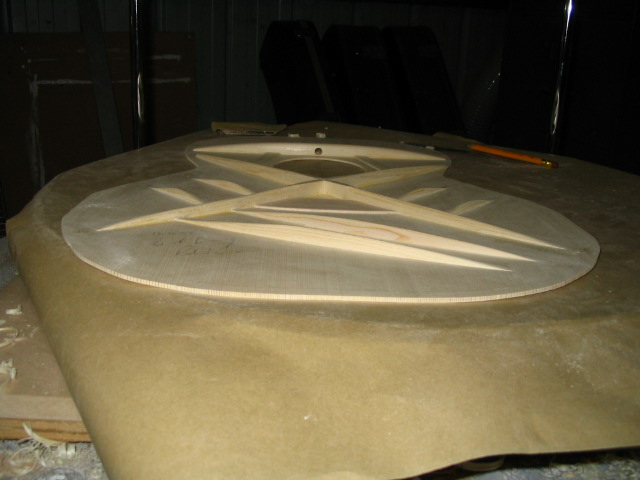

PostPosted: Sat Apr 28, 2007 8:23 am

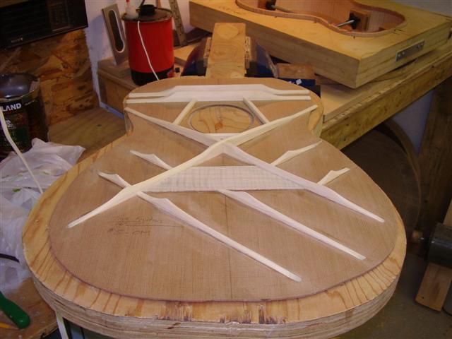

here is a shot of my latest bracing pattern on a small L-00 sized guitar...
This guitar sounded really punchy, well rounded and vibey to me...(I was
shooting for a vintage gibsonesque tone)

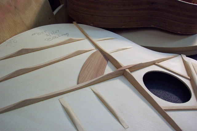

PostPosted: Sat Apr 28, 2007 9:49 am
Posts: 187
Latest shot.....

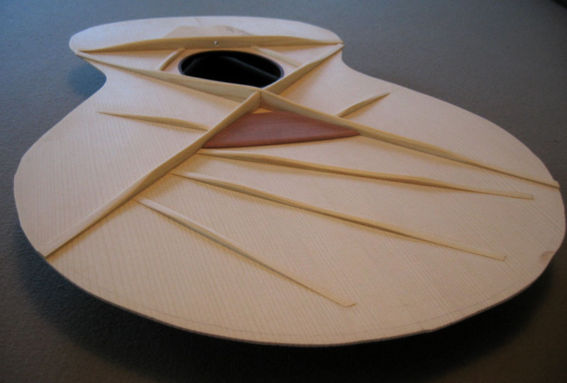

Here's my latest.
Ken Franklin

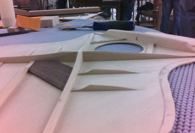

I was working on this one this afternoon and it ended up a bit dissapointing. Before I started carving, the tap tone was a dull thud and didn't really improve too much no matter what I tried.
It's Engelmann .011 with Adi braces, Maple bridge plate and the braces are about down to 'racing' spec so I'm not game to take any more off.
I'll throw it on the guitar it's intended for and see what happens. If it's no good I'll take it off and do another one.

PostPosted: Mon Apr 30, 2007 12:36 am
Posts: 698
I'm pleased to report that Hesh's suggestion worked a treat.
Took 2mm height from each brace and triangulated them again and the top took on a whole new lease of life - nice high tap tone with a resonant bottom end rumble and a lot more sustain.

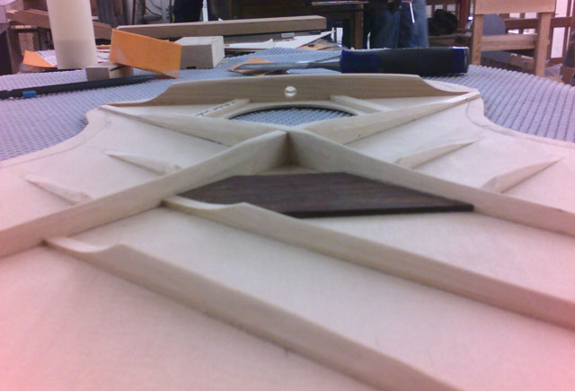

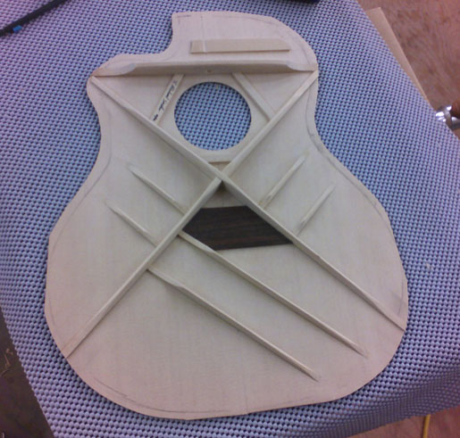

This is the bracing on my SJ. My first attempt at "parabolic" bracing.
Nothing fancy. Ended up sounding really nice though!
Sorry for the bad camera phone quality.

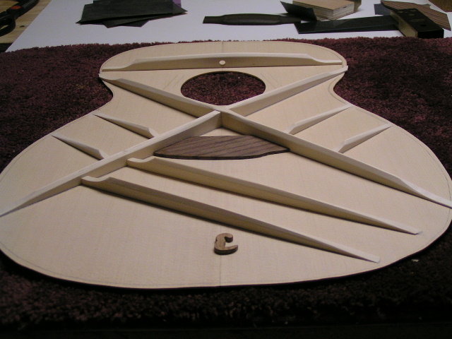

PostPosted: Mon Apr 30, 2007 5:14 am
Here is my redwood/coco OOO
I have been playing around with different patterns
