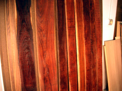

When I started this thread I did feel a little uneasy... because unlike the other forums I frequent I didn't see a buy/sell area. But you can see I am more interested in the dialog of 'how' to configure this BR for divesting rather than the actual selling of it. I won't be the last guy to bring a 'long forgotten' stash of precious wood to this forum, the next guy could learn something from this.
BTW Some more history on this Brazilian Rosewood, it was the overage from an executive office suite project(furniture and wall paneling(3/4 inch!), in downtown Chicago. Could you imagine what that was like, the Rosewood aroma must have been incredible. In the 60's I paid a week's paycheck for it, so even back then it was pretty high priced. But it was readily available. I'm still located in the Chicago area, Elk Grove Village to be exact.
So... let's forget about the 'selling' aspect of this Brazilian Rosewood for a while.
Because I want to keep the dialog going on how I should proceed. I now know that there is some usefulness(to a luthier) of the narrower 4" pieces for the backs(and that's great), so the same (1/2)board can be used for the whole instrument.
Should I consider slicing(not me but by a qualified cutter) the dozen boards first into 1/8 pieces or is that something each luthier prefers to do on his own? Is 1/8 the right thickness anyway for everyone?
And again these are 84 inches long, any cutting to length done by me may not be optimum for a luthier. The builder could select for grain character and cut to length. So should I consider cutting to length, like I see in some of these side/back kits? 42 inches would be a half board length.

I'll help you out on the thickness side of things.
You want the PRE sanded thickness of your backs and sides to be 1/8"-3/16", you need to leave room of course for sanding out cut marks from both sides of the board. Most will bring the sides down to 0.085" and the backs can be anywhere from 0.085"-0.100" after sanding.
As far as the best yield of the boards, I'd seriously considered phoning one of the aforementioned guys and talking it through with them. They of course may ask to purchase the wood from you and than sell it after re-sawing or most likely they will give you some great advise.

And Bob? Borson has a resawing service for precisely this situation. His claim is he can get more yield than an average resawing activity.
I have not used his service, but that is the claim anyway.
Can you post some close up shots of the grain for us? Is it quarter sawn?

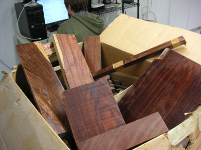

Not a 'for sale' , just asking...
Cleaning out the loft we found a box of Brazilian Rosewood cut-offs. Man, one of the width's is over 10 inches x 1 inch thick. And a 2" thick piece.
Is there a luthier use for smaller pieces like this here as a bridge, peg, rosettes, inlays? Gussets?

Yes, smaller pieces can be used for all kinds of things from headplates to bridges, to inlays, to back strips.

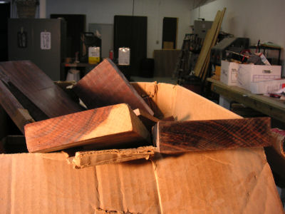

Underneath the original endgrain heavy wax they all look like this.

Doesn't look very well quartered from BC, but that has not stopped guys from building with it.
We do like to have as much of the material we use quatersawn as this is the most stable post cut state for wood. Flatsawn is certainly nice to look at but it does have more tendency to warp and greater dimensional changes with changes in humidity.
Off cut stuff like that would be excellent for headstock veneers, binding, rosette pieces, end graft probably even bridges and bridge plates.
People will always find a use for BRW

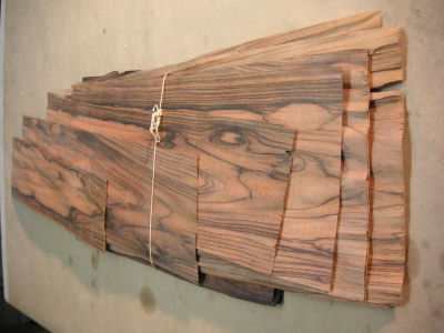

This looks like the last of it. .020 BR veneer. 12" wide x 20+30 " long and some 6" wide.
I know we are talking solid tone wood for construction, any use for the veneers in building? Maybe for decoration?

The veneer is useful for things like purfling, for a layer in a headplate, rosettes and other decorative uses.
