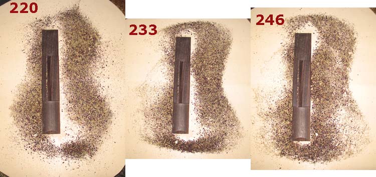

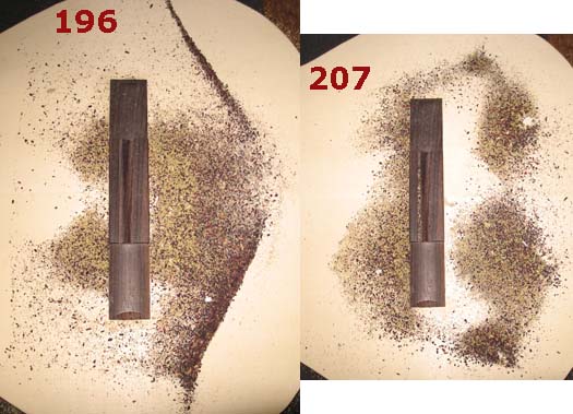

Testing done.. i hope I got it at least 10% right.  The tea dust moves from 196 to 246.9 Hz. Outside that, it's not doing much. Before each note change, I piled the dust back around the bridge.
At 196 hz it goes ballistic. At the others the tea jumping around is not so dramatic and it takes a few more seconds till I get the pattern.

yes, tea leaves from 3 or 4 bags. I made the stands from several layers of mousepad black foam, and used a 10W monitor and 40W amp 50% volume. The speaker has to be as close to the bridge as possible. At first I made another stand for it but since it was just a bit larger than the plate it felt on it while moving from the vibes, luckily nothing happened but such an event might easily crack a plate. So it's best to hold it with your hands.
It's a fun process and also smells nice :) but the whine drives one nuts.
These patterns are quite interesting. I hope Alan can make smth out of them :)

There's a tendancy for the very lightest dust to actually get suspended in mid-air at the spots where the plate is most active, instead of bouncing off to the parts where it's not moving. When you turn the amp off to take the picture there's dust everywhere, and it's hard to tell what was moving and what wasn't. another thing that would help would be to see the mode of the whole plate, not just the part below the waist. That clear line at 196 could be part of a couple of different modes, but I can't tell. Try looking at the whole plate, and lightly blowing the dust off the moving parts before you take the pictures.

It might help to add that there are 2 types of tea in there. The red one is coarse, while the yellow is much finer. It did not spread the same as the red one.

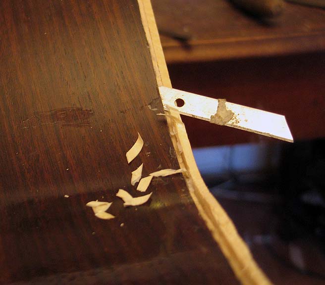

Oook, got the plate glued up.  This didn't go as easy as i thought, of course I had to screw smth up. I had it all well figured it out, but when i was forcing in the 10th gobar out of 20, the workbench (which is actually my computer desk) lifted, resulting in a few dents int he plate. With all the excitement, I simply forgot to put the weights on the dang table.
I put the weights, picked up the bars and in the end it glued up fine i think. With a blade from a cutter I trimmed the plate close to the kerfing level (this is a factory guitar with a new top, so the ledge is mostly there) and today i am going to try and make the ledge perfectly clean and square.

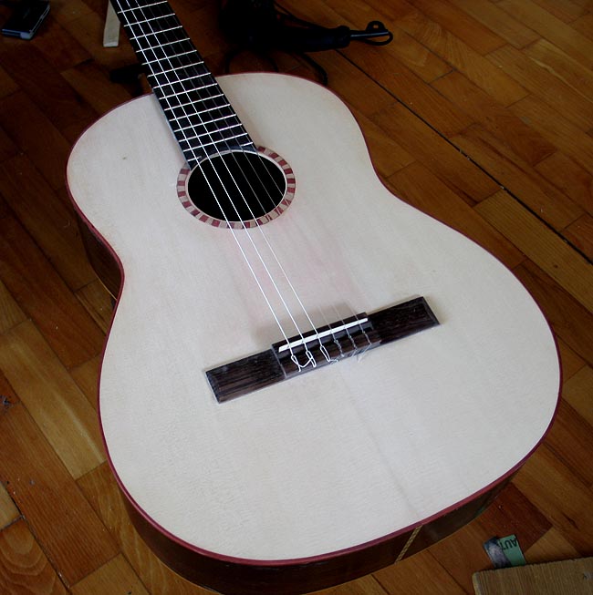

She currently looks like this.  Over the last 4 days or so i shaved a few microns off the top, then waited and listened...seems to improve every time but maybe i just imagine. I think that right now the bulk of the thickness is between the hole and the bridge (maybe 2.6mm?), and the upper bout is mostly close to the initial 2.9mm.
Here is an audio sample. Sorry for the bad playing...just learning this wonderful piece by Dilermando Reis. There is also buzzing, but I'm out of saddle blanks.
I like how she sounds.  The high E is quite strong, certainly beyond my expectations. But I could use some more overall warmth...

It's strange how she changes voice everyday. I noticed it takes a few hours after every sanding session, changes in voice do not occur at once.  The pic is took after cleaning up the yesterdays 100 grit scratches on the upper bout using 180 paper. I problably removed 0.1mm off the upper bout. Also smoothed a bit before the bridge.  Then went to bed for an afternoon nap, then played for a about 1h and noticed the sound became darker, with a bit of volume expense.  The difference is clear:
http://ursultrubadur.ase.ro/modules/xg2/engine/main.php?g2_v iew=core.DownloadItem&g2_itemId=77124
