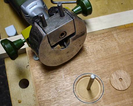

I'm a beginner at this, but this is how I approached the small radius problem. I have a Proxxon rotary tool with a router base. I could not get a small enough radius for a uke sound hole using the Proxxon base, so I made a heavy steel base for it. The steel center pin is solidly fixed in a board that the sound board is mounted on. Using a down cut spiral bit I got very clean cuts. The heavy base gives a lot of stability, but obstructs the view of the cutting operation.TomS38401.2531365741

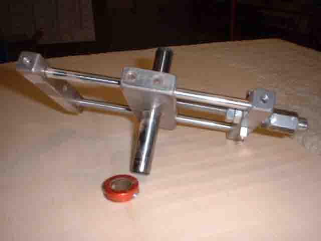

This is the rosette cutter I use myself. The other one was
designed in collaboration with Duane Waterman for LMII a few
years ago but I prefer a massive drill press cutter. I run it at
2000 RPM, and have a 1" thickness of Plexiglas between me
ant the tool before I turn it on. The red thing is a bushing set
thru the top for precise centering, in case I want to take the top
out and then put it back in. It alighns perfectly centered every
time. The top is held down with a dual chambered vacuum
device, so that when I cut out the soundhole, both the
soundhole center and the rest of the top are independently
held firm.
PostPosted: Mon Feb 21, 2005 12:51 am
Roy, I've never seen anything like that. A good combination all around. Is this something you made? Are there various size bits or do you just scoot it over and cut to desired width. Looks like an fine thread screw?
PostPosted: Mon Feb 21, 2005 5:23 am
Joined: Wed Jan 05, 2005 3:14 pm
Posts: 10
This is the latest incarnation of a tool I first made over 30 years
ago. My machime-tool skills as well as my equipment is
constantly being upgraded. The cutter is interchangable but I
use one cutter (3/64) for just about everything. The tool is so
tightly made it doesn't even have a locking screw. The
adjustment thread is a !/4-40. I have to make my own 1/4-40
threaded rod. It can only be bought in large quantities. A
digital caliper can be used for precise
