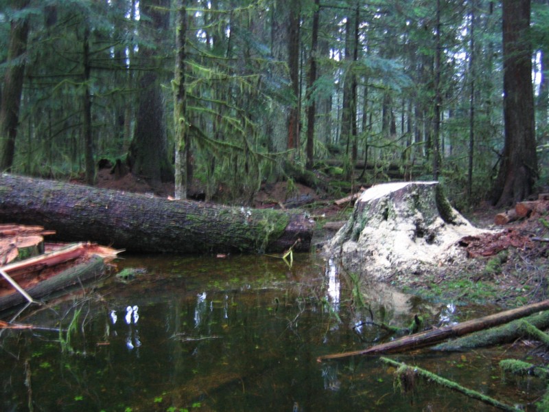

Here is a couple of shots of the trees, already felled:
The tree above is Tree 1 from this area.

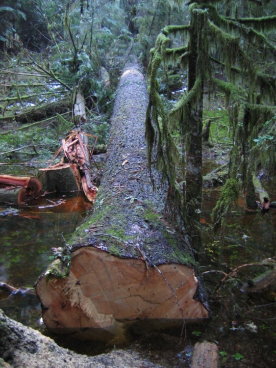

The tree above is Tree 2 from this area.
You can see standing water in these pictures. Typically you would stay away from an area like this because the trees typically grow too fast if they are near constant water but this water resulted from melting snow on frozen ground, the water has nowhere to go! The tree is in the winter dormant phase so grows very little. I have a process to assess the grain count before I choose a tree to harvest.

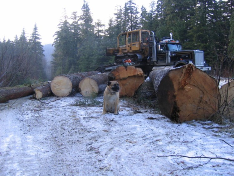

Here is picture of the logs waiting for the self loading logging truck to pick them up and deliver them to my property tomorrow.

Tomorrow these logs will be delivered to my property where they will then be scaled (volume measuement) so that the government can assess me the appropriate fees then I can start to process them. They look pretty good so there should be a few tops available from this wood for you all! Oh ya, some specs. These trees are over 4 feet across at the butt and about 120 feet long.

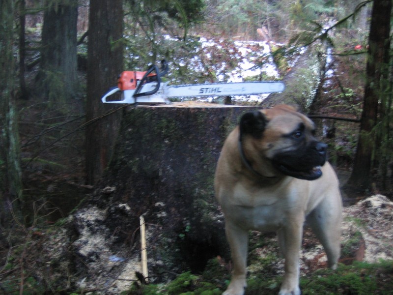

Dang, Shane. You been a-workin'. Love shots like this. So that's your 150 lb bull mastif. Loks formidable enough to keep the grizzly's away. Nice wood. If it's anything like the top you gave me, count me in on a bunch.

So behind the bull mastif that's the infamous "Stump Wood"?

The small tree to the left is Western Red Cedar? I like your working companion...great dogs...

Finding trees is very time consuming and just involves a lot driving through forest roads and long walks in the bush, with my dog. By the way Shogun is 135 pound Bull Mastif, formidable looking but just a big teddy bear. Once I locate a tree that I think may be OK (things like large girth, few lower section branches, no twist) I then incriment bore the tree to check the grain count. If the count is OK, I GPS the location and apply for harvest. To date, all of my harvest has been on Governement (we the people!) land through a special harvest licence that only myself and Mario DaCosta (Sprucetonewood) have (that's right, contrary to all his hype he is not the only one where you can get this wood "direct from the harvester"). Once a tree has been approved by the forestry department, which involves a site inspection and a review of environmental issues and accurate plotting on forest maps, then I arrange to have the tree felled and either hauled to my property and then scaled (measured for volume) or sometimes I will scale in the bush and process on site. Once the volume has been determined and submitted to the forestry department they then send me a bill based on the rate that is included in my forest license.

You are right, there is a small cedar to the left as well as a small hemlock and a small balsam. Sometimes these are removed to ensure safe falling.

Hey Shane
how does the Stihl work like? I have a similar one and really love the way she goes
Gg
PostPosted: Wed Dec 14, 2005 11:37 am
She cuts good! They make one model bigger but this one does the job and I couldn't do this work without it. Hey Luigi, what is the diametre of the spruce that is processed into tonewood over there? The engelmann I have seen over here is about 1 metre at the largest, but the sap wood is usable as it dries the same colour as the rest of the wood. On sitka and sitka hybrids (Lutz) you have to remove the sapwood as it is much lighter in colour than the main trunk but the trees are also larger, 2 metres or more in some cases, although most of the trees that I harvest are 1 metre to 1.5 metres.

Stihl is the way to go, we've got a few 066's and use them all the time.
Looks like some nice wood. I never knew Engelmann sapwood dries out. Learn something new every day
Good lookin dog too A good dog is every woodhunters best friend

That trunk has amazing dimensions, how long did it take to cut it? We do not have logs so large here and cannot have such a regular grain with european red spruce. There's only little sapwood and the younger part of the tree is considered the best one.
As for the Stihl she's great, light, powerful, very easy to handle and has a quite noiseless engine also but... I cannot forget the sound of my first big, heavy, naughty, yellow McCulloch... still the best to keep bears off the field

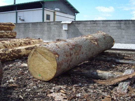

This is a nice one anyway... 112 cm (44")

I am kicking myself!! When we fell those trees I forgot to bring my camera. But I picked the faller up at 1:00, we were at the location at about 1:30 and I had him back home at about 3:15. So about 1.5 hours on-site. That includes picking the area to fall them and setting up. We used that same Stihl 066.
