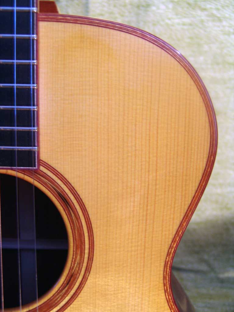

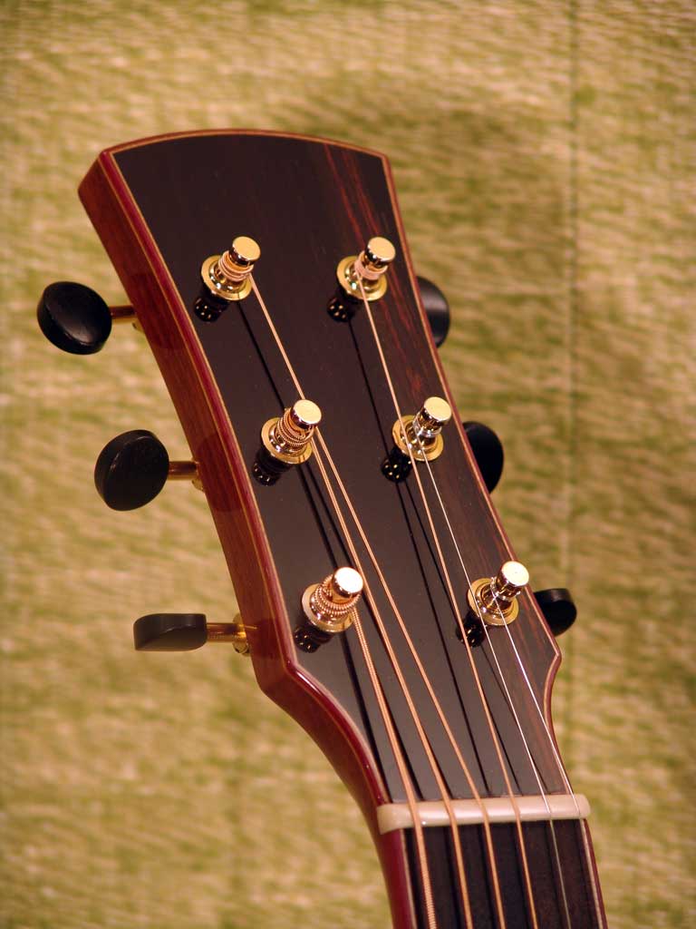

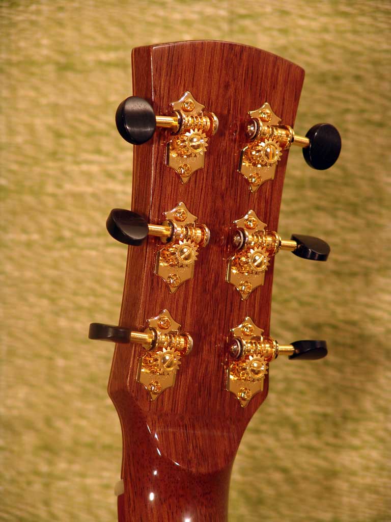

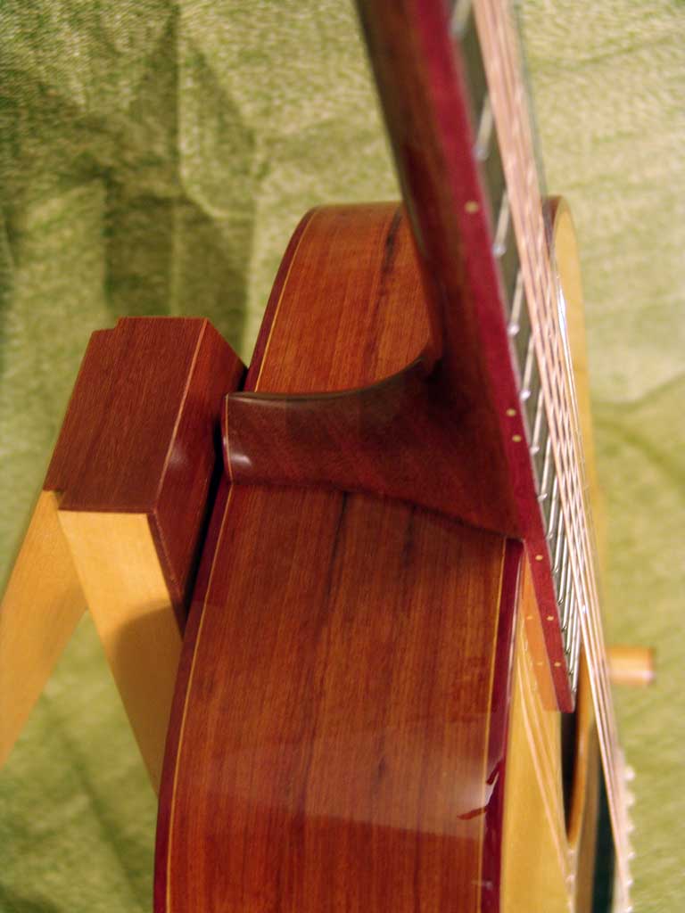

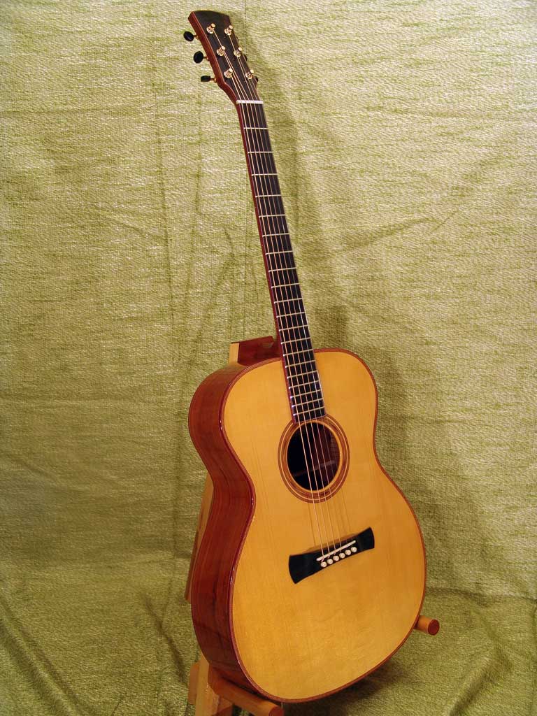

It's one of the guitars I completed at the end of last year. Happy new year 2008 by the way!
It's my take on the OM thing, perhaps a little rounder in the curves and with a deeper body. The Pau rosa set came from Bob and I have to say I really like this tonewood in spite of its (heavy) weight. The neck is made with Angelique, a mahogany substitute widely used in boat-building. It's heavier than the average Honduran mahogany, but lighter than any rosewood. I really like it and will use it again. Thanks for looking!

Very nice. I really like that rosette.

That is KILLER!  I, too, like the rosette, a lot.  Great aesthetics built into that guitar, all the way around.  Nice!

Nice guitar Laurent. I'm particularly interested in any more feedback you have on the Pau Rosa. I am just starting my first Pau Rosa build, an OM as well. My Pau Rosa is also a little heavy. Any more comments on the Pau Rosa - tone, thickness, bending?

It bends easily, no particular extra moisture or heat is required compared to, say, Honduran rosewood, although the wood is stiff, closed pores, but oily. It can be thinned quite a bit, I think the back is around .070" on this guitar. Tone is always tricky, it's a German top so… Anyway it compares to the harder RWs like cocobolo or Honduran, a lot of bass and clear attack with present overtones. It is also powerful, but again it could be more a function of the top. I'd have to build other Pau rosa guitars with different tops to judge. But I like it a lot.

Very nice Laurent! I am particularly interested in the Angelique. Where does
it come from? I guess it must be fairly stable. Thanks for sharing.

Beautiful build. Really like the simple elegence of your headstock, bridge and bindings and rosette. Love everything about this guitar - absoutly stunning - congratulations

Is that a varnish finish?

It was given to me and came from a shipyard. It is incredibly stable and stiff, although slightly heavier than the average Hond. mah. However it is full of mineral deposits so it dulls edge tools pretty quickly. The dust doesn't smell great either…

Yes, Behlen Rockhard with shellac sealer. I coloured some of the varnish coats by adding some cocobolo and bloodwood dissolved in 50/50 acetone/alcohol.

I asked because--I believe--the last one you posted had a varnish finish. And this guitar looks similar. Well, the finish does.
I'm doing a varnish finish now, and instead of the Behlen's product, I'm using Pratt & Lambert's #38. If you want some "color", this might be worth a try. This varnish is so dark, I can't see through it to the bottom of the can. I've got three coats on now, and the guitar is showing a nice amber hue.

Steve, how do you like the Pratt & Lambert compared to the Behlen? Do you feel it dries as hard, or harder, but keeping some elasticity, or does it feel softer? I'd love to see pics!

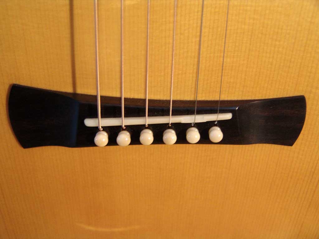

Beautiful work Laurent, nothing brash, just expertly blended colours and craftsmanship, well done. The bridge is unique, I like it very much, which wood is it made from and did you happen to weigh it??

Kim, the bridge is ebony. Sorry, I do not weigh my parts. It's pretty light though, footprint is small and wings a tad thinner than, say, Martin bridges.
Steve, pics would be great. I am always looking for alternatives, I love the Rockhard but sometimes wish I could find a very clear finish, and sometimes a darker one (which is easy enough with colours), with the same properties as the Behlen.
