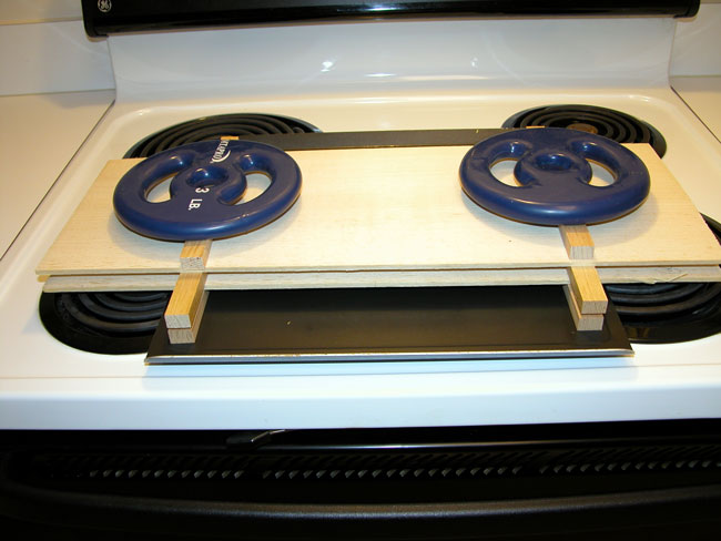

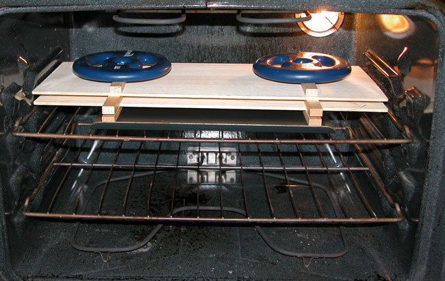

I just baked a top for my next guitar and thought that I would share what I do.
It's very simple:
1)  Adjust the oven racks so you are using one near the top of the oven - as far away from the heating element as possible.  Cleaning your oven prior is a good idea too if need be.
2)  Preheat the oven to 200F.
3)  Be sure that your top will fit in the over prior to step #2......
4)  I use a cookie sheet, stickers, and a couple of 3 pound weights that I cycled prior in the oven to make sure that the plastic won't melt.
5)  Stack as indicated in the pictures and place in the oven.  Set the timer for 1 hour.
6)  Order a pizza........ (optional)
7)  When the timer goes off turn the oven off.  I open the door slightly into the broil position and leave the stack in there for about another hour until it all cools down.
8)  Place the stack, still stickered, in your climate controlled shop.
9)  Wait two weeks or more before joining, thicknessing, installing the rosette, etc.
BTW this is some beautiful German spruce from Uncle Bob and it will be mated with some beautiful Cuban Mahogany, also from Uncle Bob, for an OM.
Thanks for looking!

If your oven is not large enough just be sure to check and see if the guitar size that you wish to build is small enough to fit.  I can put a dread sized top in my oven but I often have to trim the plates first.
Paul buddy I preheat simply because the heating element, once the oven is preheated, does not stay on long at all to maintain 200F.  I was always fearful that if I put the zoot in there and then preheat the heating elements will be on longer and increase the risk of a fire.  But I don't know this to be true, it just seems like an easy precaution to take to me.
Alex my friend I think that the fire that we read about happened because of preheating with the wood in the oven.
Pat yep my oven is dirty..........  It just seems like a lot of work to me to press that button and flip that door latch.....

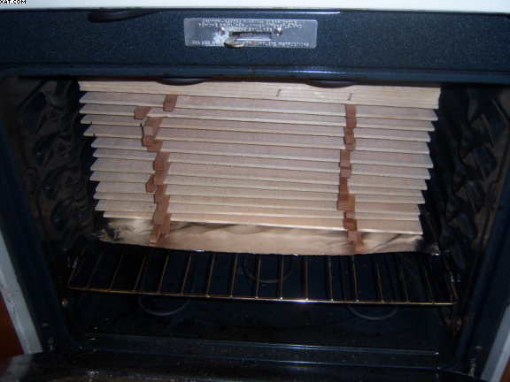

I just baked 8 tops, four at a time .. stickered up with 1/2x1/2 maple, then tied the sticker ends tight with thin wire .. 190F for 1.5 hours, on convection bake (yeah we got a fancy new wall oven ... I smell a write-off) .. let sit over night in there to completley cool down.
I wouldnt be too worried about even having the top sit flat, if you sticker it up and tie the stickers as i did above, you can even put the top in diagonally - one of my students did this and it works fine.

I think I posted this before, but I like to bake a bunch of them when I bake. I generally bake them at 200 for about 4 hours and then leave them in the oven overnight to cool down to room temp. The wood sands easier and the tops definitely seem much stiffer after you bake them.
