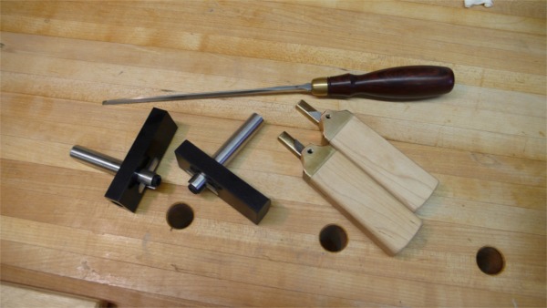

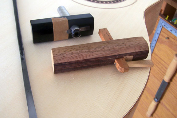

[QUOTE=Marc]I hand cut binding channels around the areas close to the neck and heel (classicals), also some at the tail. I use two lmi's and two sloane's one each set for side and top and a thin paring chisel. I find the lmi to be a more stable gramil, it doesn't tend to rock as much, but the sloane gets in tighter to the heel.
I've never seen the german one on ebay, looks like good quality, I just bought two, we'll see.

Did you make those Sloane cutters? They are sweet. I made my interpretation from an old ash baseball bat. I like yours better.

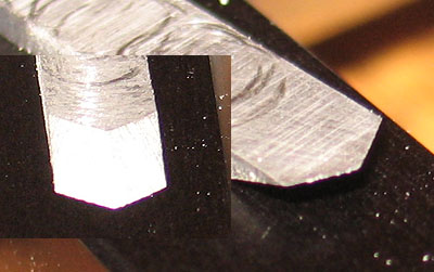

Yes, they have a center point, and the beveled side has two bevels. This way you can change direction at any time you wish.
If it is sharp and you do not force it, it cuts through spruce and cypress like a hot knife in butter. Have not tried it on rosewood yet but it should work just as fine.  It is a little harder when it encounters thick glue zones - here is where the chisel helps.
No bronze, it is anodized, probably full steel. The Sloane has a lot of bronze on it though...

That's interesting.  Does the dual bevel edged blade not create a sloped vertical on the inside of the top?  Seems like that might create a gap at the top edge of the purfling groove. I assume you mean that it is sharpened from both faces of the blade, and not sharpened only from one face like a marking knife.

Yes the bevels side has a central ridge, looks like a roof.   The bevel side must face the waste in order to avoid the slope you mention.   If you cut a purfling channel in an existing instrument, you need to reverse the blade when doing the second cut.

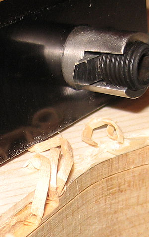

On both pics the tool is set to cut on the sides.

OK, so it is a double bevel, but is sharpened from to one flat edge like so |/.  When you look at the flat face of the cutter it will cut in either direction though like \/.

The tiny blade is a bit of a pita to photograph but oh well..

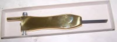

Ooops, Im talking about this thing. I think it has alot of copper in it. It is a 'simple' design, those are regular phillips head scres on the side for adjusting the blade, they work, but I was a bit taken by the initial/simple design.
It comes with 2 blades and what apears to be a well designed 2MM pick, a leveraged little chisel to carve out the rough spots I guess. For the price it was well worth it.
It has 2 blades, so I guess you can do a single edge bevel on each one, or take a chance with the beveled edge.
I will probably use a file also to get at the binding ledge. The small chisel is a bit too small from doing test runs.
