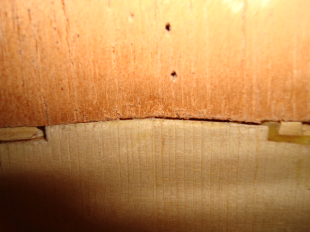

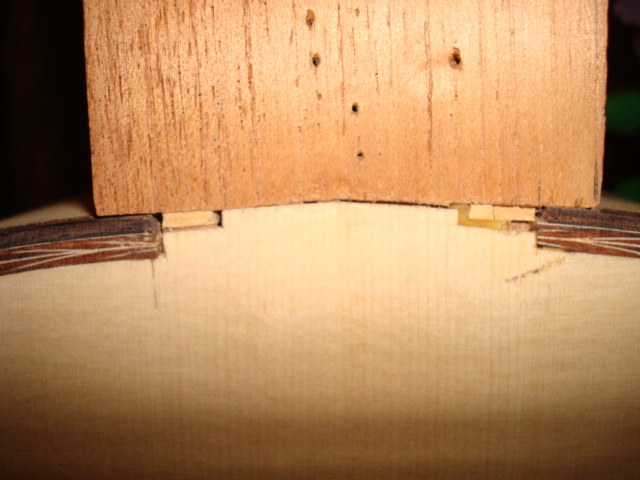

As an illustration to anyone who might have trouble visualizing this, here is the "horn" of the top contacting the plane of the neck at the 12th fret position. The top edge of the sides can be seen on either side with their uppermost edge flush to the plane of the top.
