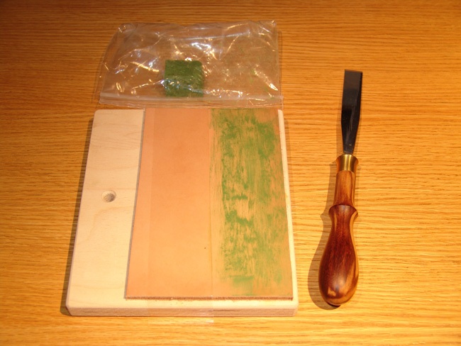

I have always used long paring chisels untill recently ordering a set of Blue Spruce dovetail chisels. Usually I would not have ordered dovetail length but since they were the only length option at the time I decided to give them a go. I was really supprised by the quality and feel of these chisels, the shorter length give excellent control for fine detail. I guess its more about the quality and balance of the chisel than the length itself.
Sweedish Berg chisels are a great buy second hand of ebay. Half way between a traditional dovetail set and paring chisels and excellent quality.
I would strongly reccomend buying just one or two best quality chisels than many of lesser quality. You will save money long term. Plus, If you chose Berg, Lie Nielsen or Blue Spruce you would not have any trouble selling them if you didnt like the size or style.

Tony, how long are your blue spruce chisels? That is the one I am looking
at.

The Blue Spruce chisel lengths are 3-5/8, 3-7/8, 4-1/8, and 4-3/8 inches respectively, for the 1/8" to 1/2" for the standard dovetail set.
As I said before, after many years of using paring chisels, I now only use these Blue Spruce chisels. They are thin bladed and expertly crafted.
If you are making your first guitar I would probably get just one or two, maybe a 1/8" and 1/2" or 3/16" and 5/8". The larger for most general work and the smaller for fitting the nut or inlays etc.
These are the best chisels I know of, but there are many other good options to cut spruce and hardwoods! The reason I reccomend top of the line tools to both newbies and experienced woodworkers is; I just feel the better tool one owns, the easier and more enjoyable it becomes to do the work asked of the tool...
