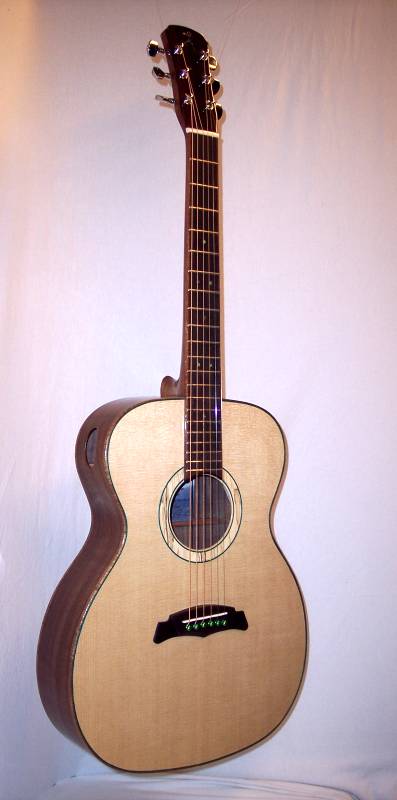

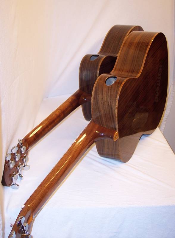

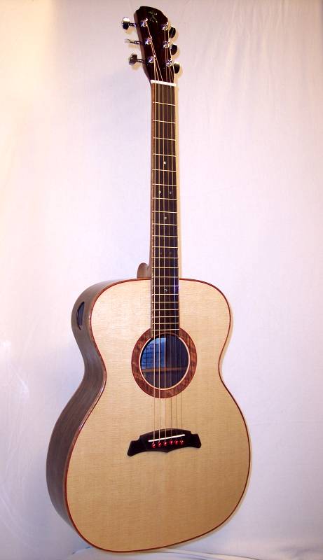

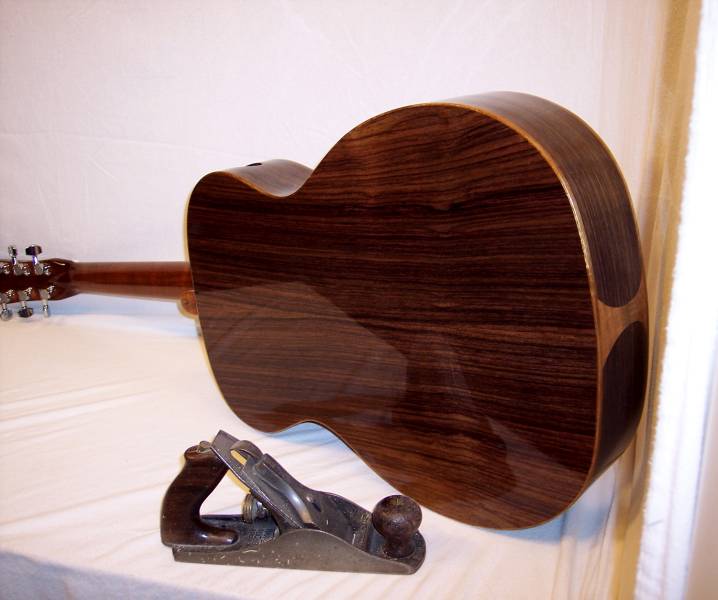

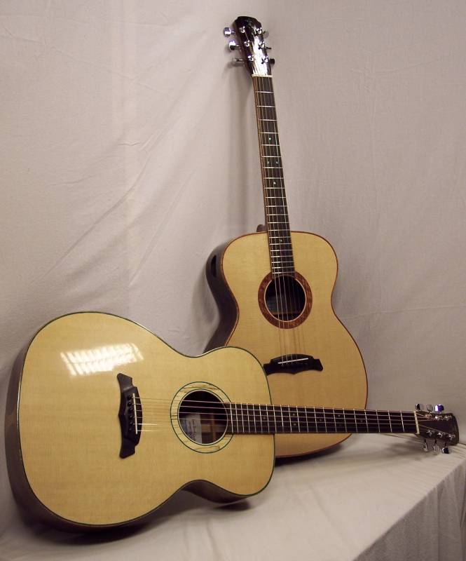

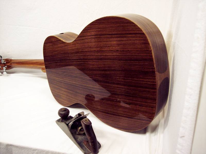

Well, I made it!  I started these two at the end of September with the goal of having them ready as Christmas gifts for my two teen aged daughters.  Well, I did the finishing touches today, and got some pictures.  Both are 000 14 fret short scale guitars and one has parabolic bracing, and the other has scalloped bracing.  Both sound really good, and are quite loud.  The scalloped braced one has a bit more deep bass and is a little louder than the parabolic braced one, but that one is a little tighter sounding and the notes seem to be a little more separated if that makes any sense.  I like the sound of both and I suspect that the girls will be thrilled with what Santa brings them.
Anyways, here they are:
Tops - AA Sitka spruce from AC Woods
B&S - Opportunity grade EIR from Allied
Rosettes - Curly Bubinga and Spalt Maple from Uncle Bob
Fingerboards and bridges EIR from Allied
Binding, heel caps, and tail grafts - Koa from LMI
Tuners - Gotoh from LMI
Finish is Target USL on the bodies, Tru-oil on the necks
As you can see, these were budget minded guitars using OLF sponsors for everything.  Oh, and yeah I know... red and green bridge pins.  Well, they are for teenagers so there has to be some kind of bling on them!
