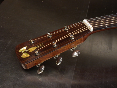

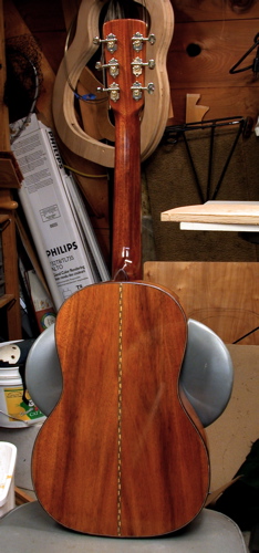

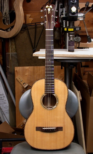

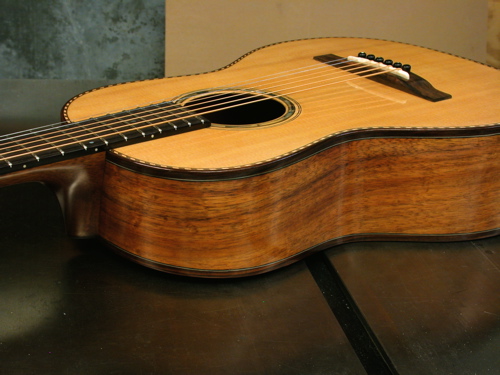

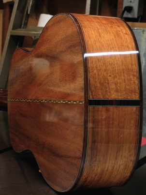

Well, here's a little terz that I started last year. Put it aside for about a year, been dinkin' around on it for a month. It's koa from Doug Kleist, Madagascar RW bindings, Lutz from BobC, I think, Martin neck off ebay. That was a weird one - nearly complete, with fretboard, but no truss rod, so I ordered a TR from Martin, shortened it and tapped it in. All FP, with a lot of great advice from Michael Payne (thanks, Michael!). FB is EIR, bridge is BRW. I had a much smaller BRW bridge, but the sound was just a bit to tinkly, so I added mass with this one, sweetened it up some. This one is for the kids, or my daughter, if I ever get around to building a "boy's" guitar for my son. Prolly be my first electric!
Thanks for looking!

Thanks for the compliments, everybody! It was really an educational and rewarding project. But then aren't they all?
John, terz is German (one of about three words I know in German) for third. It's a 21.35" scale and is tuned a minor third higher.
I chose the anthurium inlay design because they were one of my mother's favorite flowers.
My thanks again to the OLF. Looking forward to posting the next one when it's done, an EIR dread that will be donated to my daughter's school's annual fundraising auction.

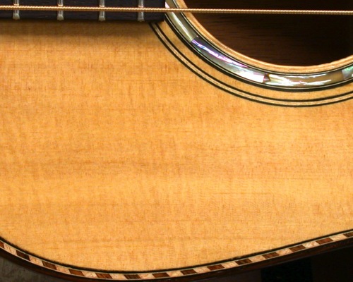

Do you have any closeup shots of the top with the rosette and top purfling detail?

JJ,
Here you go. I did this rosette a year ago. It was my first, so it's a little rough. The purfling came from LMI.
