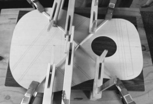

[QUOTE=zehley] How do you glue up a brace thats not either all flat or all radiused?
There are a couple of options:
If you have deep-throat clamps, you can use a flexible caul underneath and just clamp the brace to the plate- see any of the early books on building (Sloane, David Russell Young) for details.
If you are using go-bars and a workboard, just make up a workboard something like this (mine needs some contouring before use- this is just roughed out):

This is from Stew-mac's excellent free-for-download dread kit instructions.  It's very much what John described, a flexible board/caul under the top, cam clamps, etc.

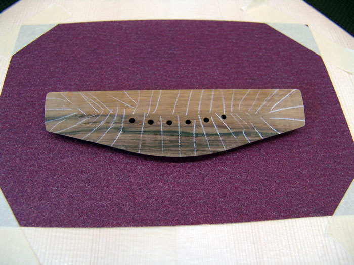

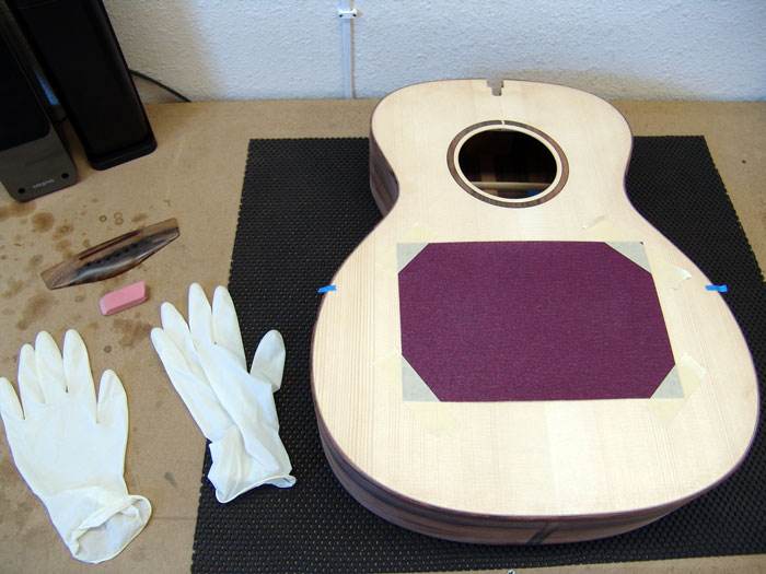

Rogue you want to shape the bottom of the bridge to match the exact radius of your top.  And the Martin style bridges that come with Stew-Mac kits are not pre-radiused to fit, nor is any bridge for that matter.
Regardless of what radius we built our tops to the reality may be that the actual radius that we achieve is different from the spec, if ever so slight an amount.
So... here is how you can easily radius the bottom of your bridge.
Using low tack tape or tape that you stick a few times to a clean towel to reduce the stickiness tape some 120 paper over the bridge area of your guitar.
Notice the little pieces of tape on the sides?  These are a marker of sorts as to where the bridge will be located forward to aft and where we want to sand on the paper.  The latex gloves just help to hold onto the bridge and are certainly not required.
Make some marks on the bottom of your bridge and the goal is to sand all the marks away.
Move the bridge on the sand paper, forward and aft, and in no time you will begin to see the marks disappear.  This is the beginning of your radius being sanded into the bridge bottom.
Just continue the process until all marks are gone and then place your bridge in it's exact location to be and check the fit.  You will see that it now fits perfectly on your top.  If you want to ever so slightly scrape the bottom prior to gluing this will provide a better glue joint but only do it with in 15 minutes of actually gluing the bridge.
Lastly, your dome on your guitar and your radiused bridge may change if you don't have humidity control in your shop so as always build, including fit, in a stable RH environment.
Hope this helps.
Sorry for the diversion folks, just trying to give an complete answer to a fellow OLFer.

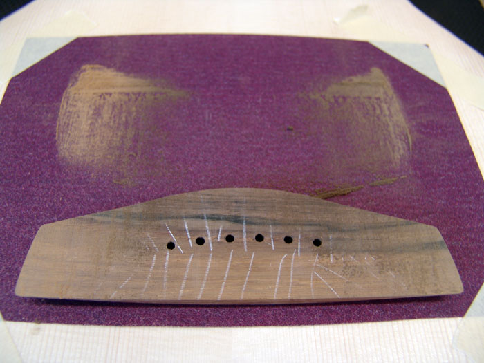

PostPosted: Fri Dec 21, 2007 5:28 am
If you mark the bottom of your bridge with a pencil like Hesh shows, and rub it on a piece of sand paper on your domed guitar top, in most cases the sanding marks in the middle of the bridge will disappear first.

BTW Greg wondered why the material was not coming off the center of the bridge bottom first....  Great catch Greg.
It's because I fake all my photos and guitars and they are nothing more than virtual creations in Photoshop.....
Seriously this bridge, in the pic, was CNC'd for me by Sir John Watkins and in doing so he was kind enough, and talented enough, to pre-radius the bottom to 25'.  So my top has less then 25' radius apparently hence the wings sanding first.
PostPosted: Fri Dec 21, 2007 5:50 am
Yea I was puzzled as why Hesh's bridge was out of plane. Arnt is right here the deepest part of the valley will be the center of the bridge so the sanding will happen there first. I don't even make marks on the center section. Instead I paint a light coat of white tempera paint on the wings and sand till it is gone on both sides. (evenly) You want to watch as you sand that the removal is happen concentrically about the centerline of the bridge, at least if you are as buttal about the bridge being level to the top as I am
