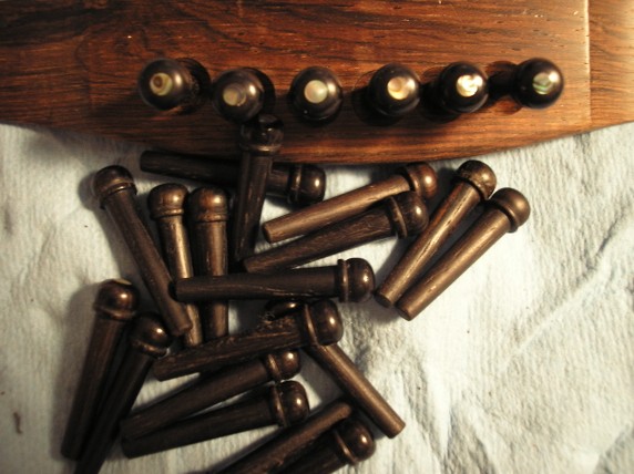

There was some interest a while back about turning pins and since I have re-vamped my set-up a bit since my last tutorial I thought it would be nice to update the OLF.
Here goes...

Again, I work my way down the first pin until the shaft hits .220 just under the collar on the head, then I set my stop and turn away.
I finish the pins off with a light 220 grit sanding and steel wool. Then a little bowling alley wax ad a trip to the buffer.
This one is ready to be cut off and put to use!
With this set up I can make up batches if pins pretty quick and the finished pins turn out very uniform in size. I'll spend a night roughing in a pile of sticks so I'm ready to cut pins if I need any in a hurry! Once I get into the production zone on these things I can get a lot done in a short amount of time.
