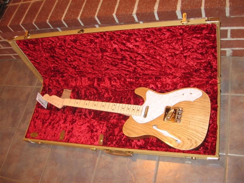

Some of ya'll may remember me talking tele a while back. This ash thinline body was a gift that sat unrealized in it's potential.
Don't you just hate all those projects you plan to do some day? Well, this is one of mine. Two years and counting, but I did get the ball rolling.
The body was stained, sanded, to kind of make it look worn underneath. Then I lacquered it, no sealer, big mistake. There just isn't enough lacquer in the world to make it seal off. So, I accepted my fate, heck no, I'm not stripping it, no way. Grin.
It buffed out pretty nice and the few gotcha's will remind me that I am a mere mortal for a while longer. Anyone play tele's? My noiseless Fender PUPs got backordered, so I'm .......back to the drawing board there.

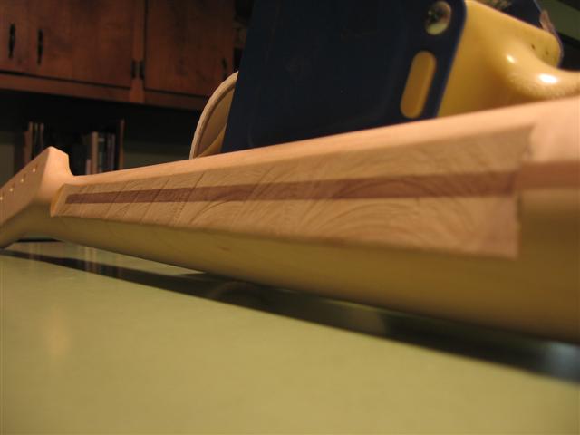

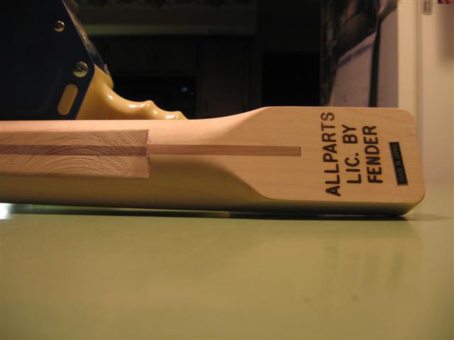

I'm shooting for a match of a Japanese Tele by Fender. The Allparts Fender Licensed neck was a bit thick, so rather than keep ordering all the different style necks I decided to take 'er down.
Careful measurement and averaging told me to rake off .050" all along the back of the neck for starters. So, I raised the neck at the nut end to level it with the body end. Then I fired up the Wagner and planed off 50 thousandths of the neck. I ended up with about a one inch wide flat all along the back, which I will fair into near the fret ends, going around the neck.

Of course the idea was to precisely remove .050 inches all along the neck shaft rear. The Wagner did the job commendably. My first use of it for anything. Just seemed right. Proud to own that tool.
She's a Japanese Tele Neck licensed by Fender, so I guess that let's 'em sell a Tele Style neck without getting sued. Pay the piper and he'll play you another tune.
Well, I have my work cut out for me now, to get this neck back booth ready. Thanks for looking.

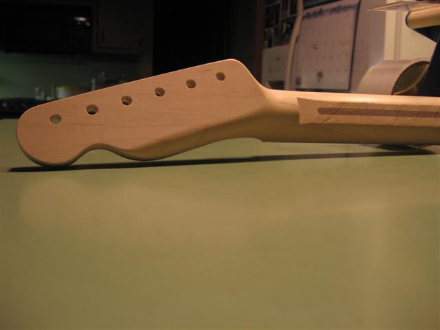

Microplane, and sandpaper wrapped on a small rolling pin covered with cork sheet.
I just walked in from the garage/ spray booth, first layer of lacquer sanding sealer laid down, hopefully by tomorrow I'll be spraying finish lacquer.
I'm pretty happy with the way the neck feels now that it's lost weight and reshaped. Way thin copy of Andy's Tele.

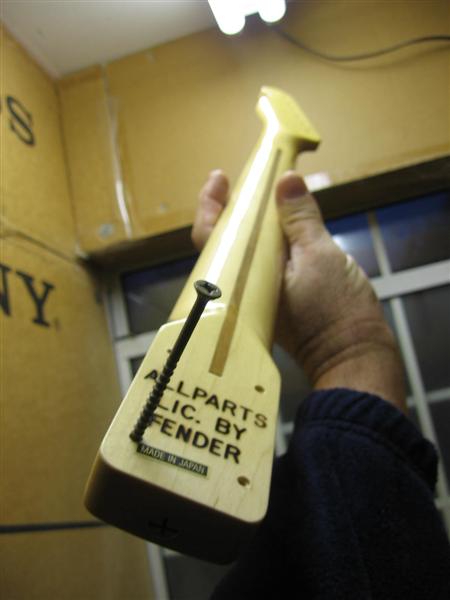

PostPosted: Fri Dec 14, 2007 10:41 am
This neck has two coats of Sanding Sealer and sanded.
Then two coats of Lacquer, I'm giving it one more. Looks pretty good already.
I'll let it harden for a week then buff and put this baby together. Rockin'-'round the Christmas tree. Now I need a Rocker.
