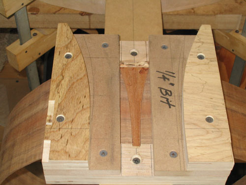

Here's a shot of my end wedge jig and the resulting wedge. I made it in about 30 minutes out of scrap. It was really just meant to be a one time jig, but I've used it now on my last 4 guitars. It's not adjustable, but I think I can make it adjustable pretty easily. I set it up to work with my dremel and a 1/4" bit. You'll see I've marked it that way to remind myself.

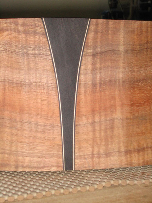

The resulting wedge:

i'm rather taken with your end graft design. it's a refreshing change from the rectangular and straight sided wedges generally in use. i'm going to have to try that soon.

So how does this work? does your dremel base reference first on one side, then on the other to cut the outer most channels then you rout out the stuff between the channels?
I have seen something similar at Dennis Scannell's site and been intrigued with this end graft design, but I am not enirely sure about how this is working.

I use my StewMac base and just place the base inside the curved guides on each side. Since it's an outside curve the base just slides along the guides. I route each side, then the middle. It's idiot-proof (well, so far, anyway). It's designed for the base to sit sideways in the jig. That is the v in the jig points to the side, not the top or bottom, although you could build it the other way. The opening would be wider to accommodate the wider dimension of the base. If this doesn't make sense, I'll send you a picture with the Dremel in the jig.
Jimmy Caldwell

Then to cut the graft that fits in the channel, do you cut it with the same method only changing the size of your bit to get the two pieces to fit correctly (with purfling).
PostPosted: Thu Apr 21, 2005 7:03 am
Posts: 460
I made a template from plywood and double stick tape it to my blank, then to the router table.
Jimmy Caldwell
