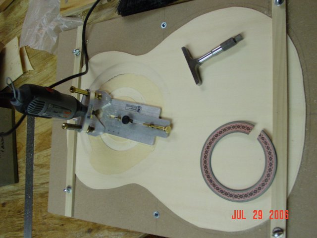

After years of lurking and the last 6 months of putting together a shop and building "getting ready" fixtures and jigs I've finally begun to get going on my first build.
I've been keen on taking my time and trying to learn from all of the great exchanges here on the forum. I plan on retiring in about 2 yrs. and would really like to become skilled enough to be a hobby builder.
I decided on a flamenco for my first build and I'm using the Reyes plans that Tom Blackshear did and are now offered from GAL.

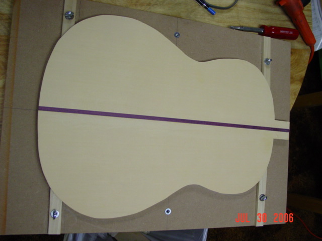

The top is spruce and the back and sides are yellow cedar. When I joined the back I put in a strip of Purpleheart and I was pleased with the way it came out.

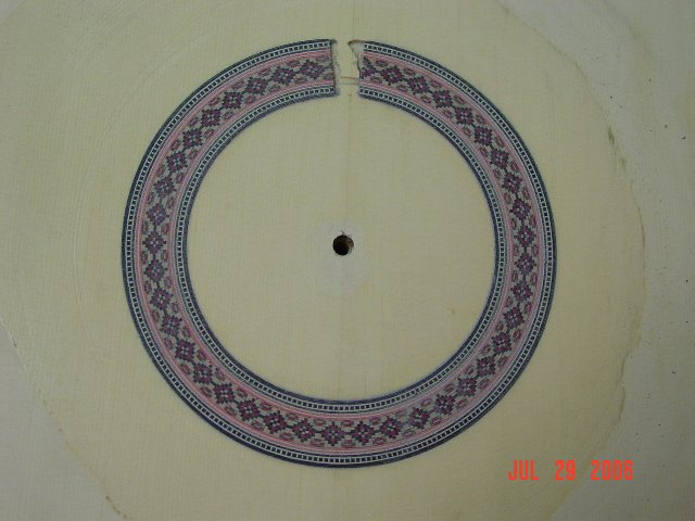

Yesterday I routed the rosette channel and installed the rosette and that came out really great. I was really enthused at how well it fit in the channel and it looks good too!
