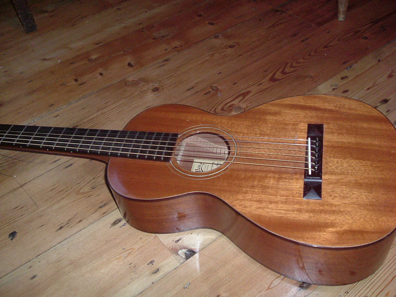

Here is my take on the same thing; my guitar is based on Martin 2-17. The bracing is laminated like the Larson guitars,2.5 mm sitka either side of 1mm Ebony.
I have also laminated braces on a Sitka, Zirocote OM it has very different sound than other OMs I have built.
PostPosted: Sun Jan 08, 2006 6:04 am
Beautiful guitar and floor Rick!
